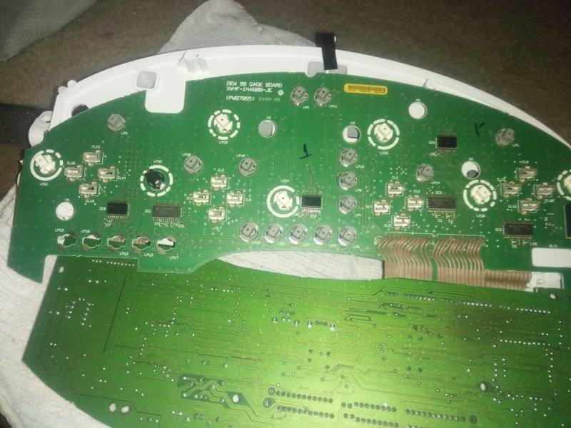

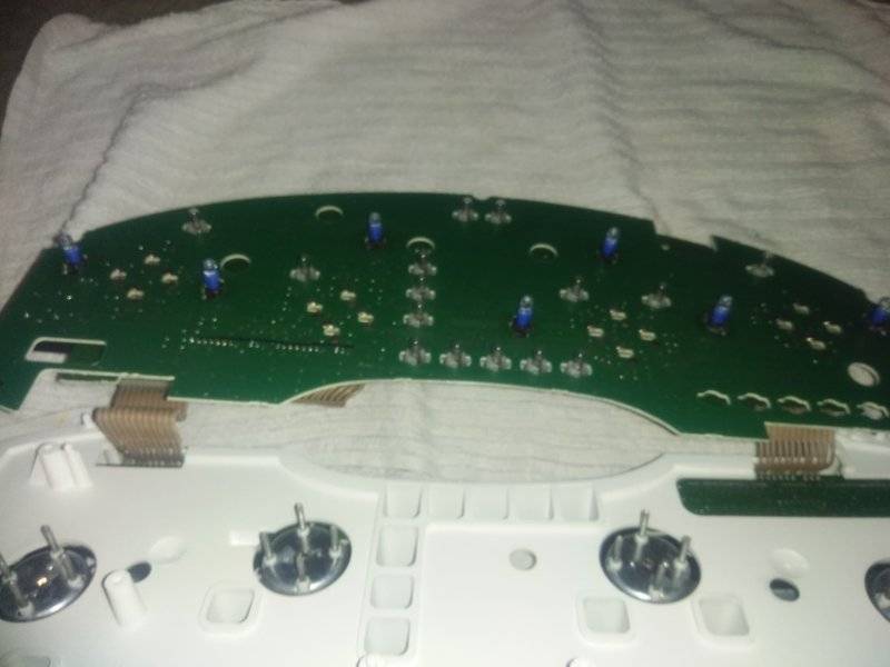

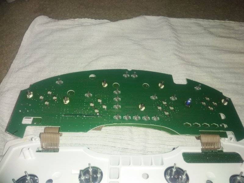

They Worked Great they make a nice tight fit just like the oem bulbs did and no glue needed. But I am thinking of replacing the smaller bulbs in the panel as well does anyone know what the size of them are. The Bigger ones seem to be T5 and the others are just a bit smaller. Once I get the new instrument panel insert I will be sure to update with pics! Pretty sure the newer style insert will look great with LED lights. Here is some pics of the fit (Sorry my camera kinda sucks)
Also this is an extra cluster I had sitting around, I will change out the others in a better area I just did this for testing purposes.
Before (I did have one changed to LED)
After
