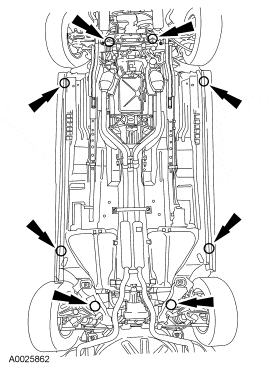

2) Where do I put my jack to lift the rear end so I can place jack stands correctly? The rear diff?

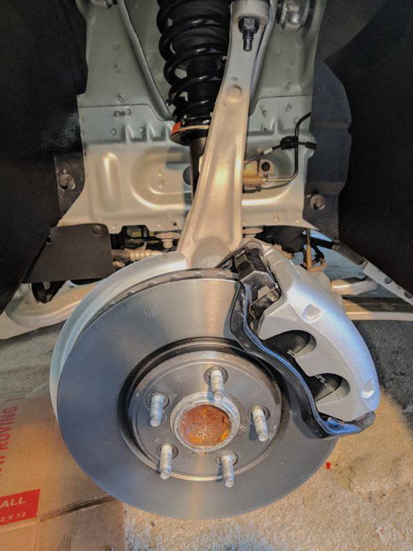

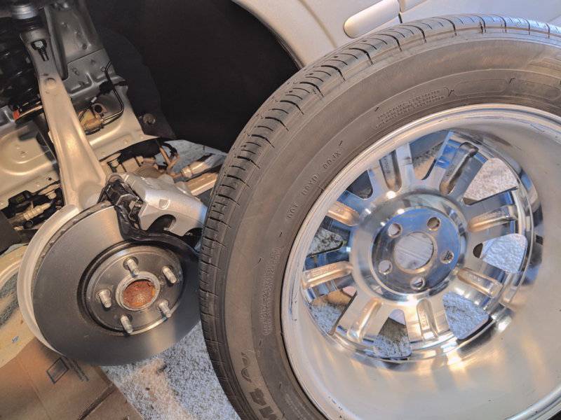

couple pics of the front after some suspension parts and brake work.
I would not lift it by the differential. It does not normally hold up any weight. It is only mounted by it's cover, not it's body.
Understand. Lifting it on the side at the jack point means I have to put the jack stand someplace else. Is there a location in the rear (x2) for each stand once it's up in the air?
