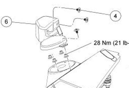

I have a question for those of you that have put the Gen I shock tower covers on your Gen 2 cars.
  • Did you also use the factory Gen 1 bracket for the driver side cover for the two upper push pins?
  • Fabricate your own bracket?
  • Installed it without the bracket?
Thanks.
I didn't use a bracket, cause the donor car I found the covers on at the junk yard didn't have one, I found the covers laying in the trunk.
I used a bolt on the main fastener location, it holds it just right and looks fine.
I remember people saying they didn't include them on the 03+ LS's to save money, but I saw a review of an 04 Tbird and it had the covers. sigh.
I used just one plastic fastener on the tower portion and it hasn't gone anywhere.
Ok, it seemed a little "flimsy" when only using the one fastener. I looked at it again last night and I may fabricate a bracket for at least one of the other mounting holes for my own satisfaction.
Thanks guys.
Just run a long black zip tie thru the two holes and the fuel injection regulator. That what I use to hold that part fo the cover and a push pin style, like the engine cover ones for the tab mount.
