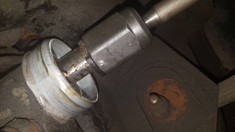

Hi everyone,
The rivet seemed too big, but I managed to use a tiny socket with small extension to hold the rivet and tap it in place. I tapped it till the head seated and then followed the instructions I found on the SHO forum
Inner Tie Rod Pic / Replacement How-To
Well their instructions to use channel locks bent the rivet. I tried to straighten it out and it broke off
How do you get this out or do i need to? Will the piece inside stay inside without the head flattened on top of it?

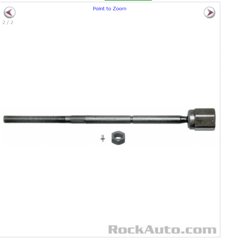

The Ford TSB didn't call for the thread-lock, so I didn't use it. Moog said they can't send me replacements rivets and said I should use Red (permanent thread-lock), I called him on it, as anywhere I have only seen the blue (non-permanent) used
https://www.rockauto.com/en/moreinfo.php?pk=202442&cc=1316153&jsn=409
He mentioned a Moog tool, but said it is obsolete. I found one site its $105 USD

Looks like room to drill? Drill it out with a 3/32nd or 1/16th drill, Alum is soft , drills easy

it did drill out easy with a easy out bit. Moog was no help saying they couldn't get me replacement rivets. I didn't want to uninstall these to use loctite to reinstall them, so I found a supplier who was amazing. Jay Cee Sales and rivet. Andrew there was nothing less than amazing! Talked to Andrew at 3pm and he had me samples shipped out same day at no charge! I still believe the hole is too small but after a many attempts they went in. Only advice I can give is go very slow, be very gentle and have tons of patience.
