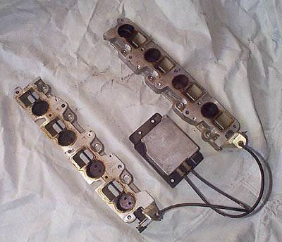

Bank 1 is passanger side. Here is pic of the assembly
thats from a second gen, 96's dont have the electrical module and cables, 93-95 imrc actuators look exactly like 96's only difference is they have a 2 wire plug on the top.
your plates look like this at the end
and your actuators look alot like these..
