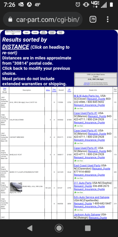

Can anyone tell me where i can buy a rebuilt 4.6 4v without breaking the bank? Ive gotta get back mobile asap or im gonna be evicted , it took me two weeks replacing the head gaskets, and probly two years off my span.
Go to car-part.com... and do a search by zip code... for the year, make, and model for salvage yards in your area. Type in what you are looking for and something should pop up
Well... the search results didn't pop up in the link above... so here's a screen shot.
