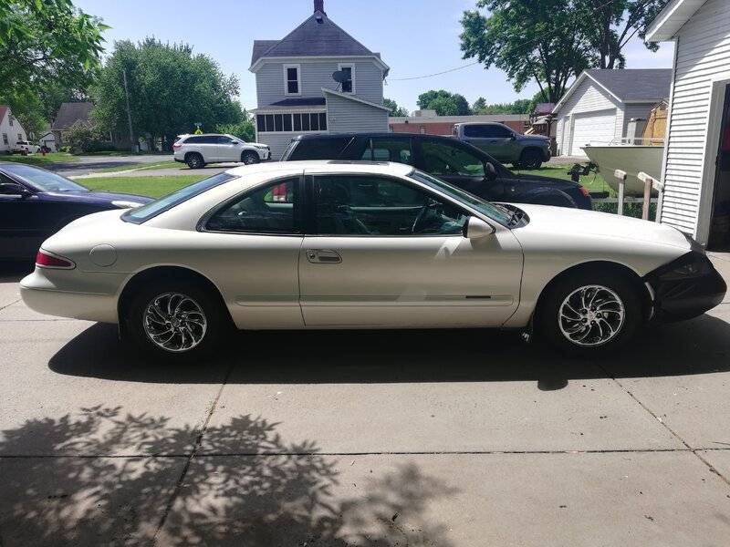

New tires have been installed. New center caps. I found some aftermarket ones on eBay with gold Lincoln emblems. I like them. I talked to a detailer and she knows someone who does bodywork in the side. He used to do it full time. He is going to fix some minor rust. It won't be perfect but will be decent and halt the rust. He knows someone who modifies Mustangs and may have a Cobra intake. I want to do the exhaust. Remove 3rd cat, X-pipe, 2 1/2" pipes, Borla mufflers, stock tips. He also knows someone who may be able to rechrome the rims cheap, but I would have to be very convinced they would come out excellent. That would be a pretty big expense to take a chance on.View attachment 828574275
I agree rechroming might not be worth it, those wheels look great b

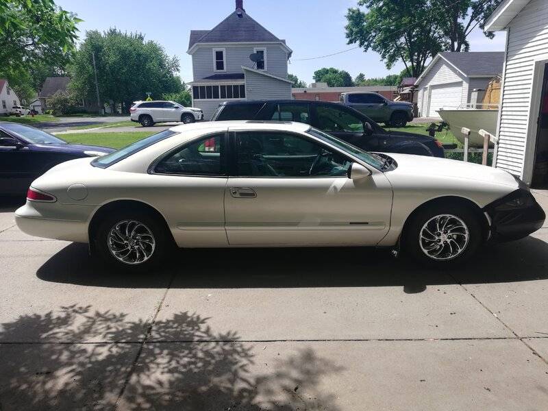

I agree with you rechroming might not be worth it, those wheels look great BTW.
