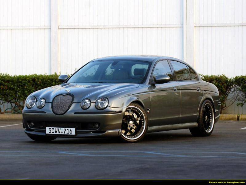

If you are serious about a LS with boost, please familiarize yourself with this beast. It is the top of the line English cousin to the LS, has the same DEW platform of the LS and a very very similar engine. To the best of my knowledge the primary difference is a longer stroke compared to the LS's 3.9 bumping displacement up to 4.2 but the big surprise is a supercharger. Output is 390 hp at the engine according to Wikipedia.
Prices are reasonable as well. http://www.cars.com/for-sale/used/jaguar/s-type/r/_/N-ma9ZfheZguzZj10Zm5d?sf1Dir=DESC&mkId=20066&mdId=21851&rd=100000&zc=26508&PMmt=1-1-0&stkTypId=28881&sf2Dir=ASC&sf1Nm=price&sf2Nm=miles&rpp=50&feedSegId=28705&searchSource=GN_REFINEMENT&crSrtFlds=stkTypId-feedSegId-mkId-mdId-trId&pgId=2102&trId=24660
Hypothetically, if I had to replace my LS tomorrow, this would most likely be it.
