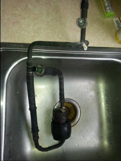

I need one of these.
RobbVII
Sep 30, 2013
123
14
Michigan

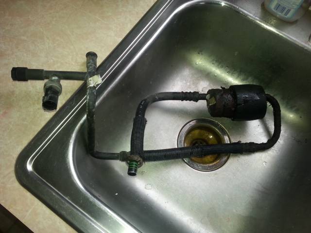

AC hose section for my 98 Mark.
Can't read - pulled part # from 97 not a 98. Might have to find a local AC shop to rebuild it for you.
Motorcraft YF2458
The one I had originally found was from RockAuto - but - I put a 97 - not 98. With a bit of work, the part from Four Seasons 55303 may fit in without issues (and that is VERY cheap)
http://www.amazon.com/Four-Seasons-55303-Hose-Assembly/dp/B0019IPZKM

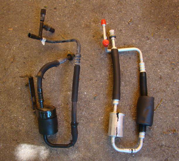

I'd replaced the AC in my Thunderbird twice over 15 years (black death) so I've gotten pretty good at getting that thing in there.
A good AC show could also potentially modify the four seasons one (if it needed to be modified) with longer hoses, etc. From what I know - I believe the back box area is simply a muffler to reduce noise in the AC system (but, I'm not an expert.)
I used the T Bird part in my 97. It's aluminum, and has three O rings, but it worked fine. :)
