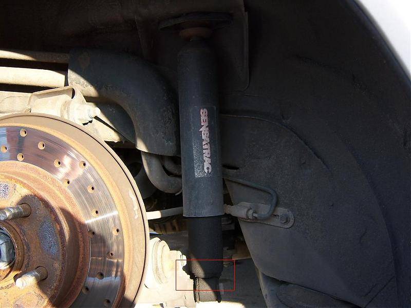

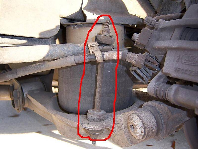

this is the the lower shock mounting bolt and the rear sway bar link pin?
should only be the swaybar link pin, since one side of the car is lifted, Ideally you want to lift the rear together.

So after the swaybar link pin is removed, do you have to push down the lower control arm so you can get the air bag out?
Thats how I did mine, took about 5 minutes to get the old bag out. Dont be afraid to go in with a screwdriver and break the plastic tabs, it makes the bag easier to come out.
No.
Once the solenoid is removed, you can squeeze the air out of the bag so it will fit through.
