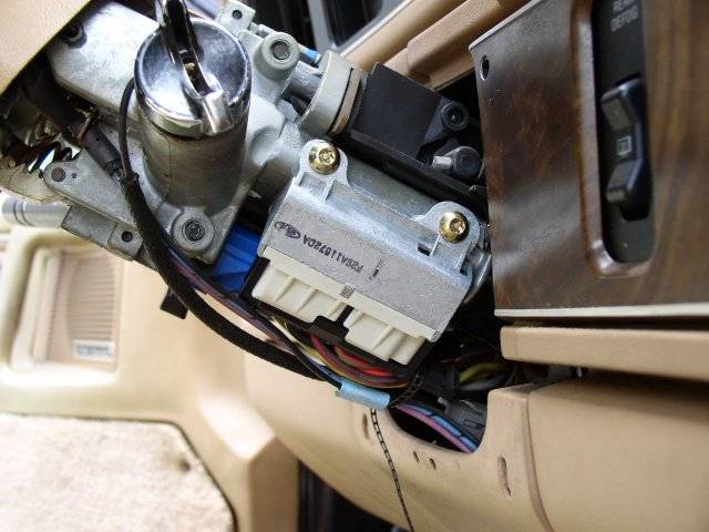

The ignition switch I'm referring to is not the key ignition switch but the wire harness ingnition switch that the key switch moves (shown below with two gold colored bolts). These switches fail and cause many problema in our Mark VIIs, especially before 1990.

A HOT IGNITION KEY MEANS THAT YOUR IGNITION SWITCH (pictured above) IS DEFINATELY ON THE ROAD TO FAILURE!
Please replace it as soon as possible.

1984 - 1989 Lincoln Mark VII Ignition Switch
TOOLS
Phillips screwdriver
blade screwdriver
#25 super torx wrench (hollow end)
MATERIAL
white lithium grease or equivalent
PARTS
Motorcraft Switch 714093 (pn: F29Z-11572-D)
Disconnect the negative battery cable
Remove the three steering column screws and the upper and lower vinyl shell.
Inspect all wiring and connectors for breaks.
Carefully remove the decorative collar by pulling the 4 - 6 push-pins that hold it into the dashboard.
Located the grey and tan (aluminum and plastic) ignition switch. Compare it to the part that you bought BEFORE you remove it because they are not returnable.
If the two screws that hold your ignition switch in look like these, then there is no doubt that you are looking at the original switch (a bolt with a rivet-like head). These can only be removed by chiseling/cutting slots into them to be driven out or use a set of needle nose vise grip pliers to grip once and turn out.
WITH EXTREME CARE, just barely pry the black latches away from the switch to disconnect it. Remove the switch and compare it to the good switch. Bad switches normally are separating or rattle or (gulp) burnt! A burnt switch means that you may have just saved someone's life as the next step may have been a steering column fire.
CAREFULLY install the new switch and check for operation before putting the collar back on.
