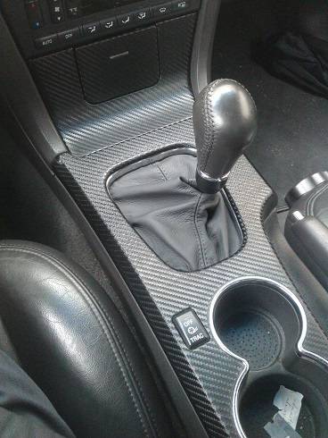

I added a leather shift boot to my automatic LS

I REALLY like how this looks. I think it looks a lot better than stock factory. This is on a Gen1.

I ordered it from Redline Goods. They were TERRIFIC!! When I first had questions they were emailing back within 20-30 minutes of me emailing them. I was really impressed with that. They were very helpful. Since they don't have our car on their list I looked around at other cars and measured. I ordered one for a '99-'04 3-series E46. I entered in my measurements as if I had a short shifter and they took care of it. It is a terrific, quality boot. They have a lot of available options.

No, sorry they hadn't. I just gave them the measurements they asked for but if I was to order another one I would add another 1/4" - 1/2" to some of it. I can't find my measurements I gave to them but I will keep looking.

I was going to ask about that. It looks GREAT, but I would be worried about tearing it as it looks at it's limit. Looks like this won't work on the 2nd Gen.

This was the email from them on measuring for it.
To determine the proper shift boot height drop for your short shifter, we'd need you to measure:
- distance from front corners of shifter plate to where you want the top of the shift boot to be located
- likewise distance from rear corners of shifter plate to where you want the top of the shift boot to be located
It needs to be measured across the longest travel distance. So if you have a typical setup of 1,3,5 on the front and 2,4,R on the back, it would be 2 for front-right corner, R for front-left, 5 for rear-left and 1 for rear-right corners, respectively.
You can just paste that info in the comments field on the order form and choose shift boot height adjustment to OTHER (it's one of the available selections). We'll take it from there! :)
So, I gave them, "front-right corner 2 1/2", front-left 2 1/4" , rear-left 3" and rear-right corner 2 1/4"

I would very much like to see the bottom seam a bit more straight on.
also, how does this thing fasten to the bottom of the console ?
