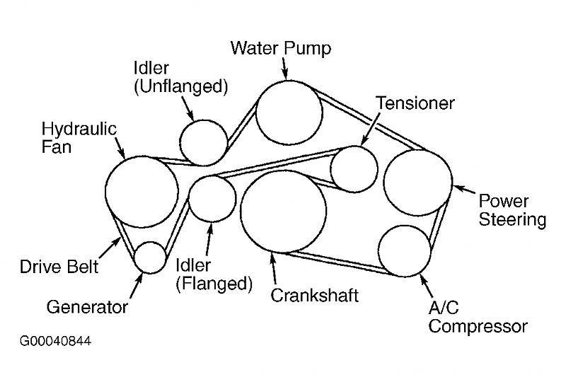

Just another idea is the belt installed properly with the correct routing?
I like your thinking. I would have to double check this. Is it possible to install the belt improperly and everything else still work? If so, can someone please post the diagram for a 01 LS 3.9

I attached the belt routing diagram for the engine.
The vane is on the back of the fan. Its the internal workings of the hydraulic fan. If you remove the four bolts from the back of the fan connecting the pressure line to the fan you will see the rotary vane. But if you didnt disconnect that line from the fan you don’t need to worry about that.
The belt has to be right, groove to groove and smooth to smooth, it would be impossible to put belt on wrong, at least without getting a different length belt. I would pull the line line off, pressure or return stick it into a jug and see if it pumps at all. if it pumps it is a bad fan, if it does not pump it is the pump of course, My fan runs all the time just just real slow when cold.
