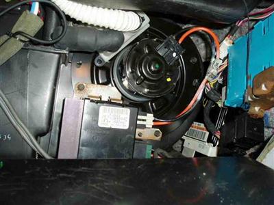

Did you wire the motor in backwards
Check all vacuum lines
Impossible to wire it in backwards - it only can be attached one way.

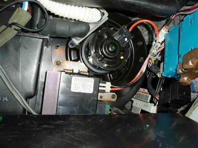

By "cable" I mean the "wire harness" that goes between the blower motor & blower control module.
In the picture above, it has the orange/black thicker-gauge wires.
It only can be attached one way.

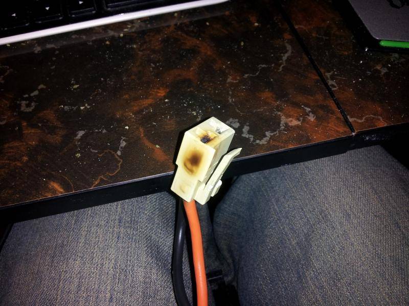

Below is a picture of the damage that occurred to the original connector that attached to the blower motor control module:
My connection issue seemed to originate back there, not on the blower motor side like many others who encounter this common problem.
(FYI: The connector on the blower motor control module was also burned, so I replaced it with one from a 2001 Mercury Sable just to be safe.)
