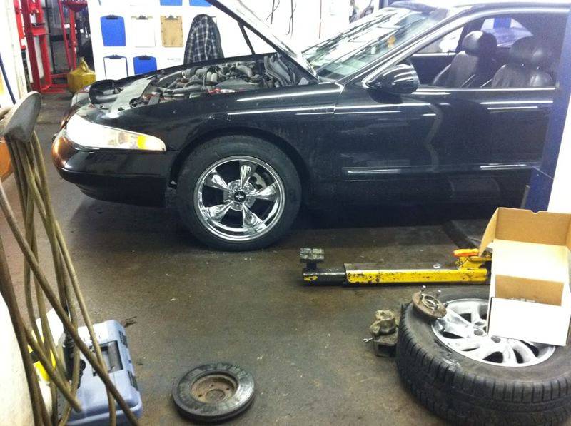

Got it done little under 4hrs

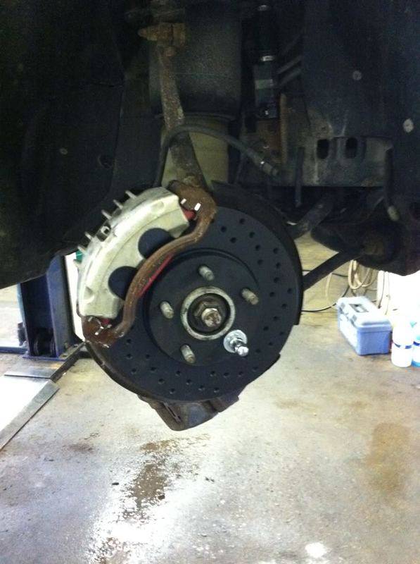

Had to play around with relocation brackets for a bit they were home made and had to notch both front calipers for the mark viii flex hose to fit correctly and also trimmed 1/2" of backing plate for caliper mounting bracket to clear

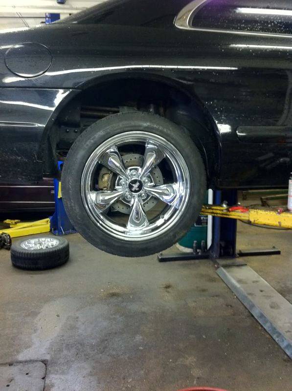

Here is a couple pics was crappy out and was dumping rain when I finished no real good pics Yet
Yes I plan to do something with rear calipers
Car sits much better now that was as soon as I let it down without turning air ride or key on
nice, can we get some photos of the car from a distance? where your old rims chrome or painted?
