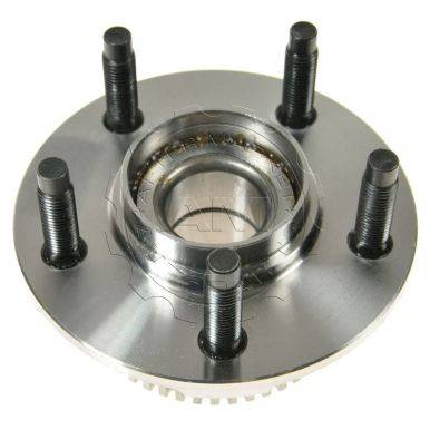

Correct me if wrong but aren't the center bores on the hubs different sizes between the mark viii and mustang? If you have mustang hubs in front no centering ring would be needed..I get that..however in the rear since I'd be using stock mark hubs (redrilled) wouldn't you need the centering ring to make up the size difference for the hub center? The center of the hub is what "centers" and holds the wheel in place when its mounted..not the lug holes. And yes I realize I used the word "center" like 5 times in one breath lol

All OEM Mark VIII wheels as well as OEM Cobra wheels are hubcentric. It doesn't matter what lug nuts they use, they center via the HUB :rolleyes:

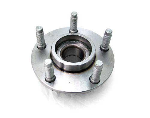

In the front, mark viii uses a step hub, where the rotor has a bore of approx 70.80mm and the wheel has a bore of 63.90mm. Once you swap to front cobra hubs, the wheel bore increases to 70.80mm and is equal to rotor bore.
In the rear, the hub is sized 63.90mm for both the rotor, and wheel.
If you reuse (re-drill) your rear mark viii hubs, you will need a hubcentric ring for the mustang wheel as the wheel bore is 70.80mm. The mark viii rotor will center just fine as it did before.
Lug centric wheels have tendency to vibrate a lot more than hub centric wheels. It might be fine for drag cars, but not for a daily driven car.
Do it right and either use a cobra rear hub and corresponding rotor, or use a centering ring. That's the way it was designed to be.

Ok..you guys realize you're saying opposite things here right?? Just to avoid confusion we should remove the wrong info or just edit it. But thank you m maker..very good info here I get it now..its hard trying to picture what some of you are describing but I understand now..I did not know the fronts had a stepped hub with a different dimension at the rotor bore vs the wheel bore. Again, thanks for the input guys!
