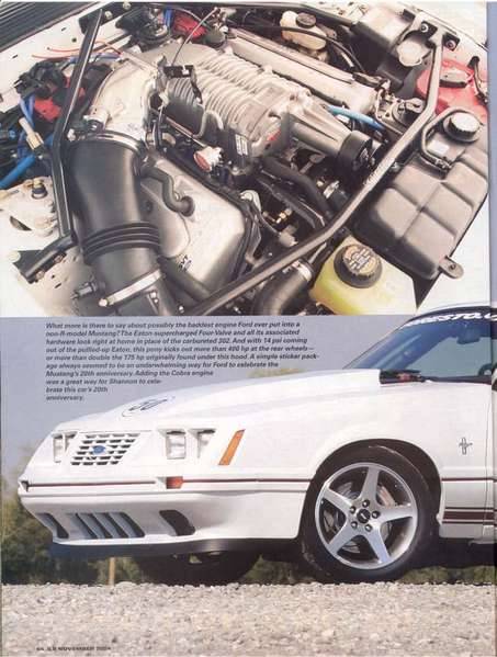

What kinda info you looking for, I have already successfully done this swap in a Fox platform, using an early OBD-2 and retro coil pack insted of coil on plug style.
Really it can be done with the OBD-1 with realitive ease and some programming.
Nothing at all is unobtainiumn ;)
