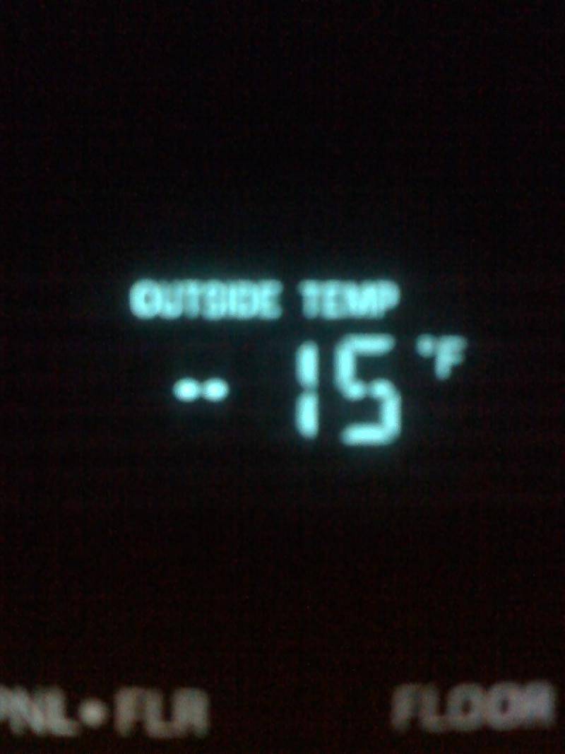

mine started fine last night it was -15 and -38 w/ wind chill

And how would I get that reading? I know the HVAC is reporting the right temp. I was pumping a lot of very warm air into the filter location so the car was bringing in warm air.
