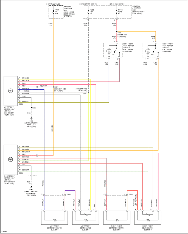

hello all, I’m in the process of installing some heat elements in my gen 1 LS. CAn anyone provide me the link on how to remove the leather? I saw it here a while back and cannot find it again. Also, a pin out diagram for the harness under the seats would be nice. Thank you all!
Diagram can be found in the repair manuals.

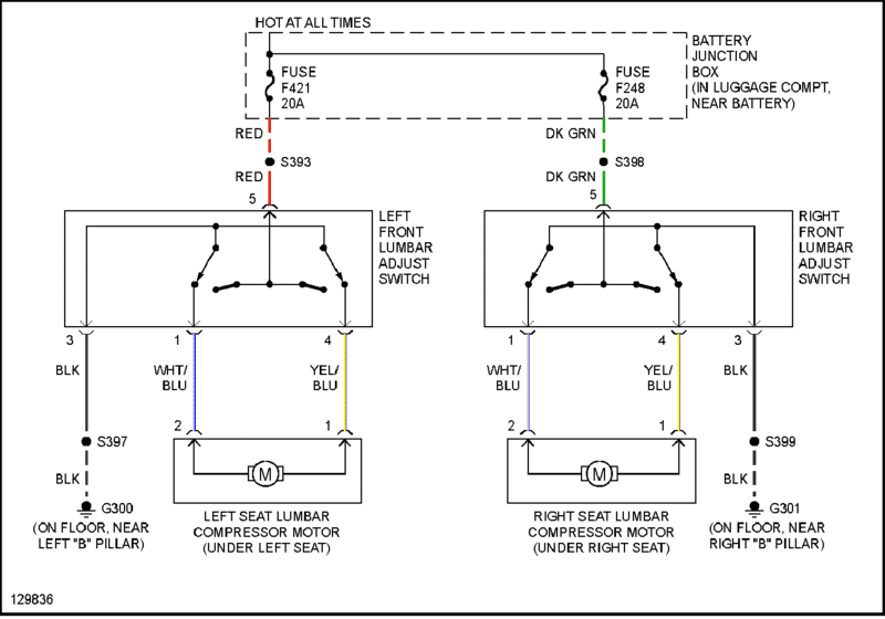

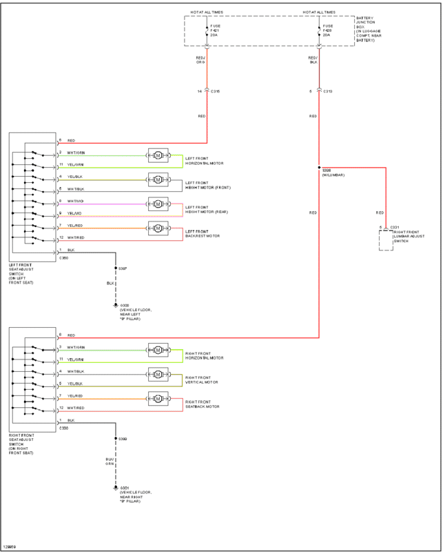

seat diagrams
Thank you Joegr for the diagrams. Now one quick question, would the harness/wires exist under the seat if the car never came with heated seats?
