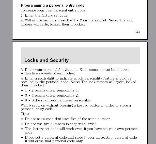

I tried to program a user settable code for my keyless entry but can't get it to work.
I followed the instructions from Lincoln:confused:
I can erase the codes but when trying to input a new code, I never get the feedback to enter "my code".
Has any body experienced this?
From the manual
What "feedback" are you talking about? When I do this, there is no feedback beyond the lock cycling mentioned in the instructions.
Type in the factory code (the 5-digit code on the blue and white card in your owner's kit), and then press the 1/2 button. The locks will cycle, then enter your new code, followed 1/2 or 3/4 or 9/0, depending on which Driver Setting memory you want associated with that code.

I can't get the locks to cycle!
But when enter the code and press 1/2 twice, then the locks cycle letting me know the user programmable codes have been erased.
I did get it to work. I did just as the instructions said and the new code works! The locks did not cycle like the manual said in step #2. They did however cycle when finished (step #4).
