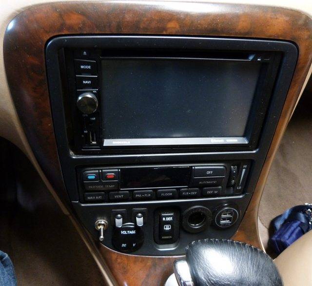

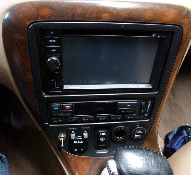

Yeah, if you go to the Crutchfield web sight, you can put in your car then the various head units will be shown and the instalation kit required will be suggested that has the wiring harness that goes between the new head unit and plugs into the OEM radio plugs. The wired connectors in the kit usually need some soldering to make up a complete plug n play harness connection. If you buy everything from Crutchfield, they have a CS line that will walk you threw the wiring. They are very good at that. Been there n done that! I bought this Boss unit from them that has the back up camera and nav. I run it in threw the OEM amp just as was suggested by them and am quite happy with the unit.
Very good. Looks like it's just come out of the factory! Sounds like just what I'm looking for, as I can't kneel on anything anymore, so whatever has to be done, I have to do it sitting on the seats. What brand and model is that?
Also, I see additional what appear to be USB ports; do those go to the head unit as external usb drives with music/video could be used on the screen? I'm able to do soldering and wiring, so that would be a nice extra.
This is the one I have and the USB port plays thumb drive recorded music perfectly. I have hundreds of songs on a single drive and like the way I can scroll way ahead or way back on a music file If I dont feel like that set. The reviews were accurate on this Boss unit. Im very happy with the power level in that with the loudness button on, the bass is not drowned out by any road or engine cruising speed noise. I have tinitis in my left ear so the wide range of the equalizer is pretty good off our factory amps. The GPS is not a Garmin but adaquit for the most part.
Of course, it tells me they're out of stock! Oh well, I checked the 'notify me' box, and will see what happens, in the meantime, I'd shop other units to see what's available, but 12 out of 14 they have listed as fitting our cars, are all listed as 'out of stock, unknown availability'. I haven't ordered from Crutchfield in many years, but remember them being very helpful before. Thanks for the heads up! I'll keep searching.
