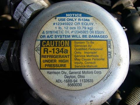

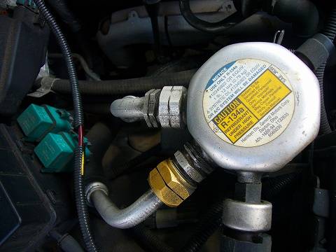

Attached pics of dryer/accumulator
Hi MAC1, thank you for the reply. I will check it again. Yes, I got a gauge too. Is the dryer the same thing as the accumulator? I see the black cap on it. It's on the passenger side. I attached the photos of the dryer/accumulator. Is this the thing you were talking about? Thank you.
