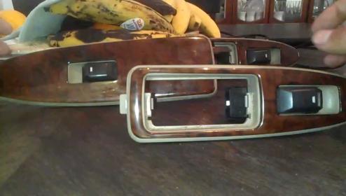

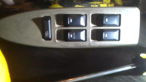

Ill be showing you how to change the green factory leds to any color you please. Im actually going to change mine to white.

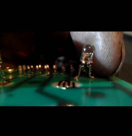

These are the blue ones and they are 3mm. They are $3.48.
http://www.ebay.com/itm/190825273851?ssPageName=STRK:MEWNX:IT&_trksid=p3984.m1439.l2649
These are the white ones and they are 3mm. They are $3.48.
http://www.ebay.com/itm/161006714505?ssPageName=STRK:MEWNX:IT&_trksid=p3984.m1439.l2649
This is the resistors you need 560ohms resisitors. They are $1.49.
