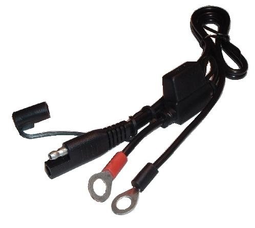

What's the best place to connect a ring terminal connection (for a Battery Tender) at the front of the car? I want to start using one of our trickle chargers on my two cars since they sit for 4-14 days at a time and the Taurus died on me a few weeks ago, just sitting there. I usually park with the nose facing the garage (where the charger will plug in) since the front halves of my cars usually need more work than the rear.
I know there's the positive post in the front passenger fender under the AC filter. Good thing the battery was unplugged when I found it... I thought it was plastic garbage in wet leaves/debris and was trying to pull up and out with pliers. I could have easily shorted it to the body if I grabbed it wrong. I had no idea what it was at the time. Oops.
Any better spots, maybe closer to the lower grille? The plug has a cap for when it's not in use, so I'm not too concerned about water. I'd just rather not run a new cable the length of the car.
The supplied car-side cable has a fuse within 2" of the ring.
Many of the circuits in the front (under hood) fuse box are live all the time. The location for fuse 17 on a V8 should be a good one to use, since that fuse isn't used on the V8s.
Sounds perfect. Thanks

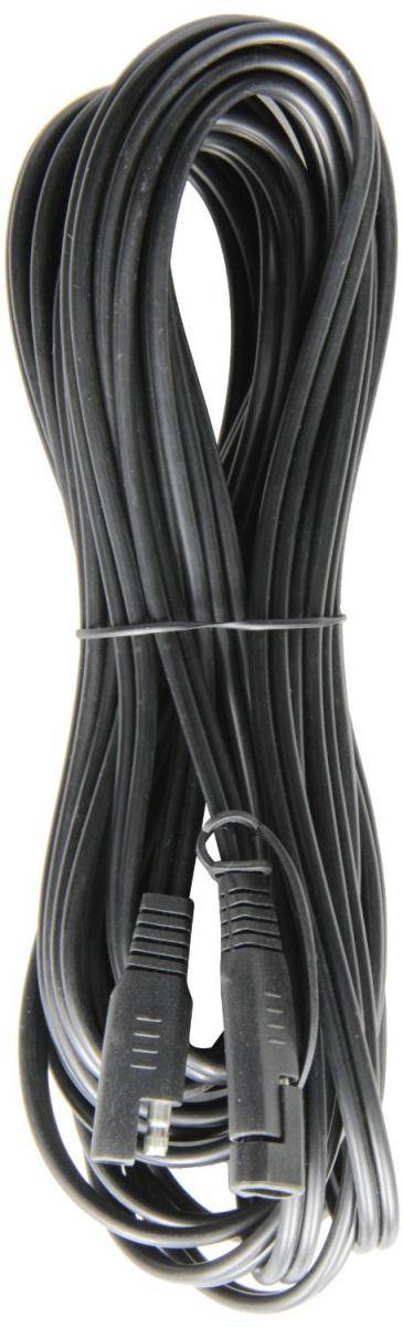

I use a Battery Tender with a 25' extension. I also added a "permanent" attachment to the battery.. Both available from Amazon...
Each kit comes with a ring terminal attachment and an alligator clip attachment, so I have that. I just figured having the plug at the front would be easier to handle than running the extension under the car. The easier it is, the more likely I'm going to actually use it.
