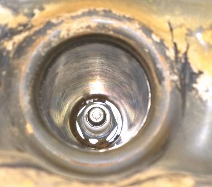

Mine developed some stumbling soon after passing 51K recently, but didn't throw any codes. I figured $200 for new coils and plugs is a reasonably cheap thing to try and a likely culprit. Passenger side looked pristine. i was so proud of my car. :D Then I took off the driver's side cover and saw a little oil in three cylinder wells. The photo is the one with the most.
I guess the coil(s) failed on their own, because that's a really small amount of oil, right?
I'm tempted just to clean those few drops, and check again in a year or so. What do you think?
Also, what's this yellow rustlike powder all in the coil area (only on this side)... coil cover needs a better seal?
I would go ahead and replace the VCGs before it creates a bigger problem. A kit should come with the gaskets for the plug galley covers. If it really starts to spew oil in the galleys then it will mess up the coils.

False alarm, lol, turns out that wasn't oil at all (yay) just some dust and crud that had collected. Some shots of compressed air and vacuuming cleared it out. I put some new sealant on the coil cover plate to help prevent that in the future.

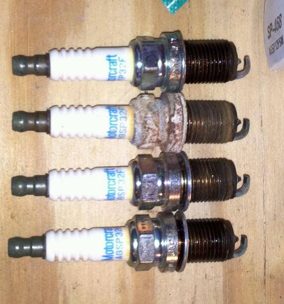

One of the LH plugs had some serious corrosion... I guess that was the misfiring cylinder? :confused:
Looks like that one was getting some water in. I would expect it to be #4 or #8.
