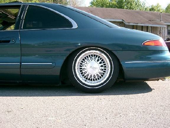

i'm not dragging,i don't think the tires are rubbing,but can i sucessfully drive like this?it's all the way down,purposely.

If nothings rubbing you probably can, but good luck with speedbumps, and the ride will most likely be TERRIBLE!
Driving around on the bumpstops is not the safest or smartest thing to do. I would seriously advise against it.
not to mention incline ot decline driveways / parking lot entries. COuld get yourself stuck or wreck your front end........
I dont think so............
....depends on if there is any air in them --- doesnt look like you have any, which means you basically took the bags out of the equasion ---
IM not totally sure on this one though. Ive never known anyone to do this. I dont think you'll be able to drive on a regular basis like this though, too many things can get damaged, and sooner or later, will. One high speed bump might just hang you up.
I drive mine around low like that, but be prepared to replace your entire front suspension. Ball joints (upper/lower), tie rod ends (inner and outer), and most likely your tires as well. When you lower it, the front end toes in and the front tires do not ride on the whole tire, they ride on the inner most part of the tire, so when you go to get it aligned your tires will no longer be any good because you will not have any tread left, but the rest of the tire will most likely be fine (unless they are already in need of replacement.
So, yes it does cause problems, and the bags could suffer as well. What happens with the bags is that you now are exposing different parts of the bags that were not exposed before. So, IF there is a small crack in the bag that you did not see, or was not exposed before, it could possibly expose itself. Now, that is not sayin that you will have that problem, but that is just something to be prepared about.

i usually drive it about an inch higher all the way around,but i did some trailer towing yesterday,and it was all the way up,so i had to drop it,i was just surprised that it'd roll that low without rubbing,in order to get the back up,i'll have to raise the front all the way up,and cut the switch off before the back gets too high,and then wait a few days till the front goes back down,and then play the switch game to keep it there,wonder if there's any way to drop the front back down after i get the back up a little,rather than wait,oh yeah,the compresser,doesn't vent unless i pop the solenoids out,or take the lines off.

Driving it that low is not very smart, add about an inch to the front and rear and that's about where I cruise mine. I do dump it down entirely on occasion when the streets are FLAT and I'm cruising the loop. Normally I drive it a tad bit higher but I'm always trying to get it as low as possible while keeping a nice ride... Ironicly, my front tires have worn very evenly over the last two years.

If the pressure drops below a certain level in air springs/shocks it damages the bag/shock as the part isn't designed to be able to sustain that weight/strain using just the rubber of the bag/or shock liner. Low riders real low riders have suspensions designed for it i.e. suspension compnets are moved and redesigned and strengthened in some cases, also they are designed to be functional at a more extreme range than a stock air system on a car. Also if you notice lowriders generally don't have a car 100% dropped while driving at all 4 wheels espically at any good clip. Riding around that low on the stock air system is asking for a huge repair bill, I wish I had that sophisticated of a suspension on my towncar to wreck, except I wouldn't wreck it, just an expression. When driving lowriders or hydro cars usually sit up at an even level for normal driving. And cars that do the 3 wheel motion hopping etc.. have special tires and rims as well as revised suspension pieces to be able to sustain those acts over and over without causing damage.

I do agree with you that driving it that low will destory the bags along with the rest of the suspension.
