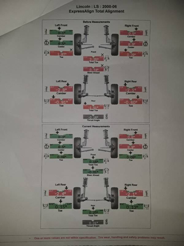

This was my last alignment. Has 6 month warranty. Which as y'all can see they didn't leave it in the green. They suggested camber bolts for the front. Which I hadn't heard of those until now. But I guess they go on lower control arms. But how do I fix rear? I need the rear torque tie rod and sway bar links. Would those fix it?
Unless you've been in a wreck, I feel like your rear control arms (probably lower, but I would do both) are worn out.
Now that I can read the numbers... doesn't look like anything to write home about. Sway bar links don't do anything for alignment. Rear tie rods only (directly) change toe. Since the Toe is spot on, I wouldn't worry much about 0.2° camber on the front and <1.5° on the rear. I can't see the unnoticeable additional wear on the tires being worth the cost of control arms if they're stable and tight
I think it got worse since then. Car feels unstable af. Hit a bump and it pulls right. Tires are wearing pretty bad.
Forgot to put the tire wear is on front. Car in back feels wobbly. But I think it's the shocks. Or could it be upper control arms?
