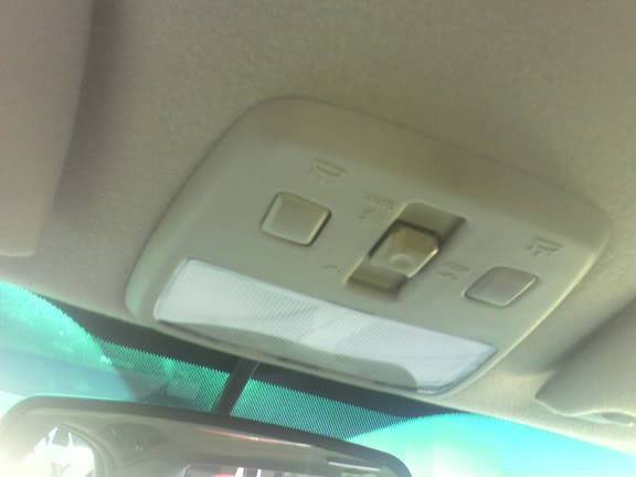

i am not sure how to get this piece off. i want to get in there to see if something is wrong with the sunroof switch since it closes on its own when the bass hits. is there a relay up there or just the switch. also when i try to open or close the roof i have to turn the music down and wait at least ten seconds before the switch works.
so i got it open and the switch for the sunroof works but the relay or whatever it is has a huge delay from when i move the switch until the glass starts moving. does the whole headliner have to come out?
did you pull down from the sunroof side first? or the windsheild side. I have to pull mine down as well.
We just went through a mess with our sunroof. I would have sworn up and down it was a switch. Nope. It ended up being the motor itself. Dealer replaced it under warranty. 9 months later...with the car now being out of warranty...the same problem popped up. Dealer did the right thing by us and replaced it again under the parts warranty. I sure hope that problem doesn't pop up again!
i was hoping it is the switch but it doesnt really make sense if it is. im going to the dealer right now maybe they can sell me a switch so i can eliminate that.
i pulled from the windshield side and it is a bi1ch. two snaps stayed in the headliner and i broke the passenger light switch. guess i'm gunna pick one of those up too.
