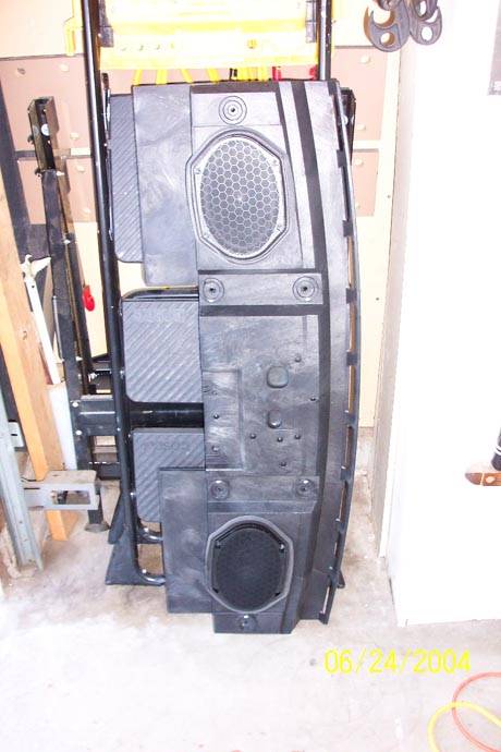

- there are 2 6"x9" subs in the reardeck driven by there own amp (on each side of the third brake lamp - you access them from inside the trunk)

- remove the rear subs, amp and plactic mounting deck - replace with aftermarket amp, kicking subs and a sub box

My stock subs werent 6x9s more like 4x6s...
sorry - I should have been more specific - the doors are 5"x7" the subs are 6"x8" - remember that the 5x7 and 6x8 are almost interchangable ;)

(measure your subs again - you'll see that the MOUNTING is not 4x6)
