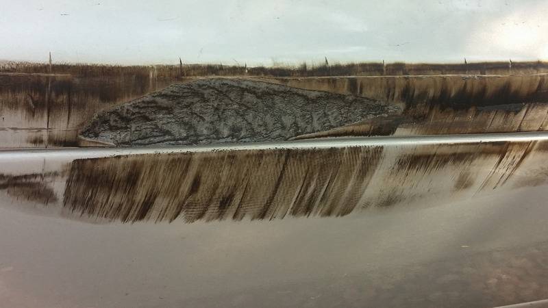

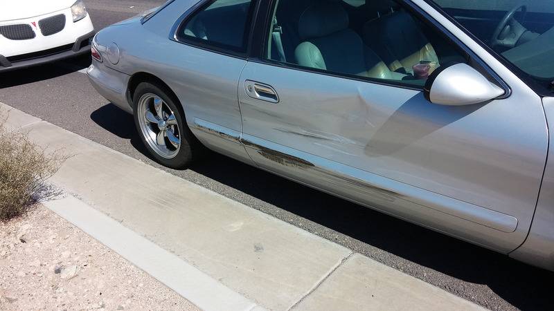

This is what the one on my car looks like, the other driver just kept going and it wore it pretty good:
20141012_134514 by dabangsta, on Flickr

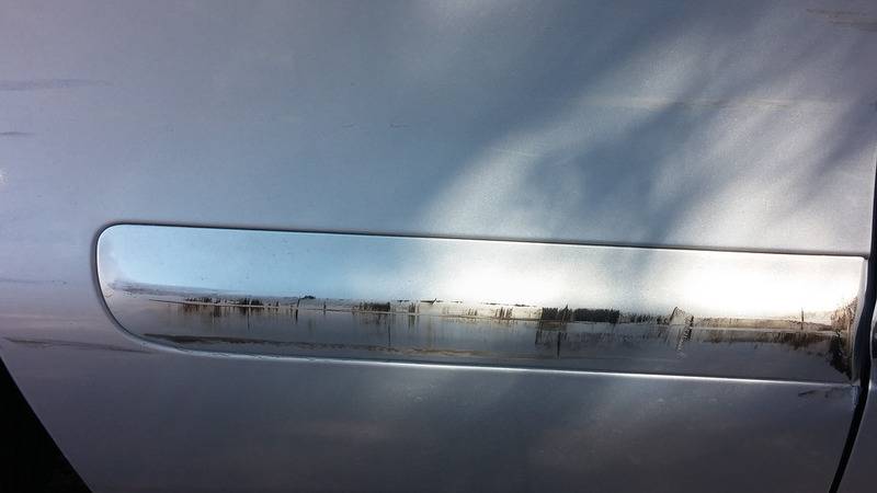

The quarter panel trim isn't great either, I don't think it is salvagable for a bodyshop to call it good (at some point I would probably call it good enough if doing the work myself):
20141012_134243 by dabangsta, on Flickr
20141012_130001 by dabangsta, on Flickr

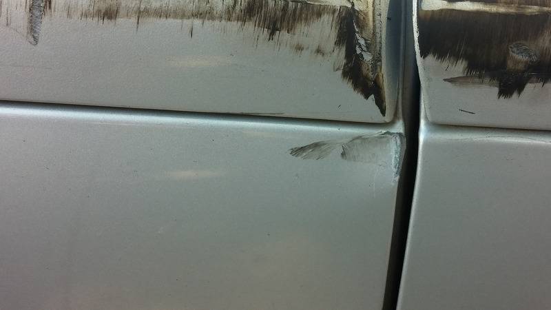

This damage seems to be the part that worries me the most, the metal is split and a chunk is missing.
20141012_134506 by dabangsta, on Flickr
The correct use of a heat gun and a putty knife will aid in removal. All 95-98 LSC had this trim and it's 100% interchangeable between gens. I'd pay $85 to have them at my door allready removed from a car. There is a 3M addhesive that people have used to re-attach the trim but I dont have that info at the moment.
From looking at my recently acquired 97 LSC moldings, they are held on by double-sided tape and lined up by the pins on the back side of the molding.
Removing the old moldings requires a heat gun, putty knife, and patience. Clean-up is best served by a plastic scraper and some MEK or acetone (be careful as these will soften your original factory paint).

As for the metal door itself, it can be fixed but would be quicker to remove/replace. Then you could fix that door for a spare!
