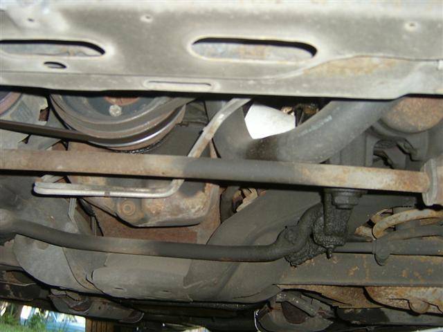

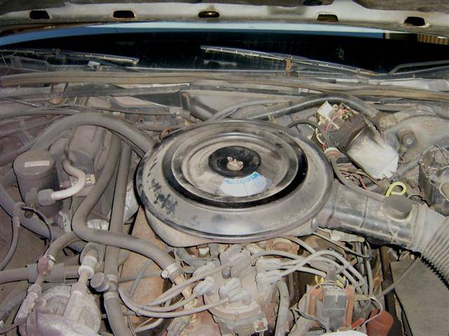

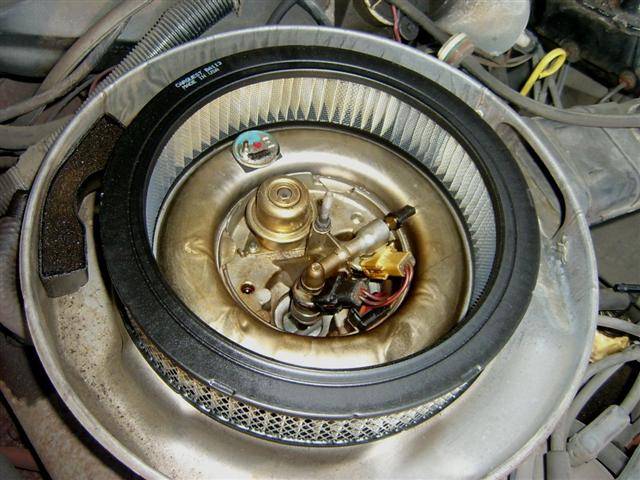

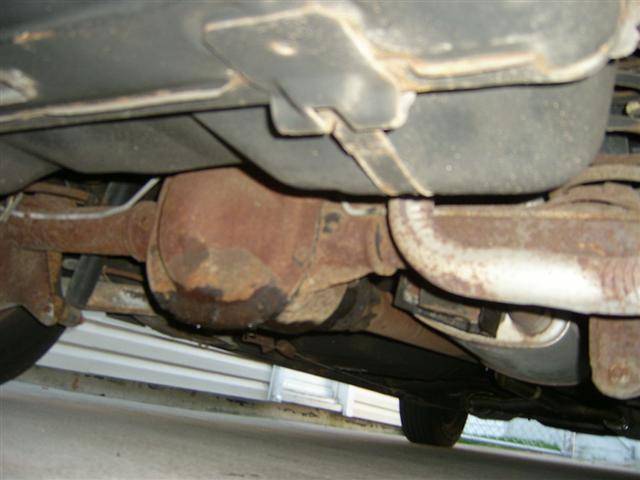

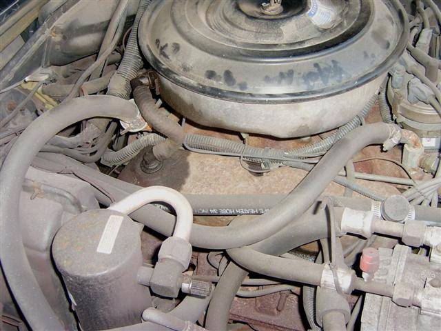

Couldn't resist this one, I took some pics, some not too good, but from these can you tell me what I need to get at first?
1985 Grand Marquis, 1 owner, 62500 orig mls, interior seats clean no tears or rips, engine pics reflect a 21 year old 302 (I am already on the wire over the lid). And yes, the rear was hit 10 years ago re-painted from pasgr. doors on back, he's 2-toned cept front and back not top & bottom!

Doesn't simple green make an engine degreaser? Geno has a brand that he likes alot and wins shows with, PM him.

Powerwash that engine bay..nothin like gettin greasy!

KD00LS, Mr. Wilson, Frat-man-du, just how should I go about cleaning all of that! Go looking for the simple green engine cleaner or another method?

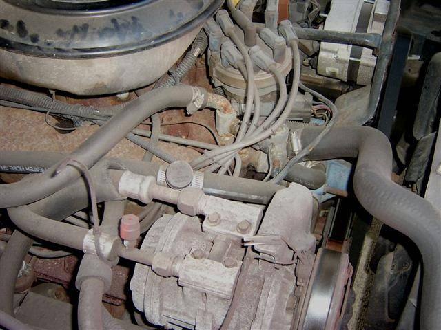

Oh, change the PCV valve, too. That might be why you're getting a lot of oil in that breather element in the air cleaner housing. And of course, change that breather element.

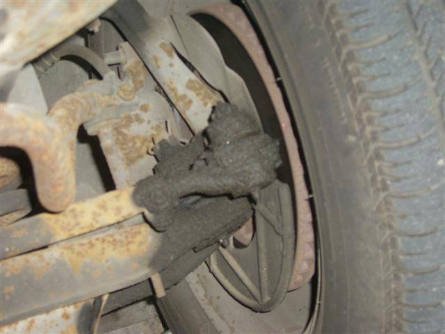

NYC LSC said:
Looks like either the pinion seal or rear diff cover needs to be replaced.........Oh, change the PCV valve, ....of course, change that breather element.
Looks like I've got a date tonight, and tomorrow and the next day....lolol Thanks NYC, let me know if I need to take pics of anything else. Wow, how can you tell all that!!!!

Debi, i agree with all the recomendations you have been given, also an oil change, new plugs and wires, new distributor cap and rotor might not need it but you can't go wrong putting new on there and with summer coming on you might want to think about getting the radiator flushed out to get it ready for summer time.

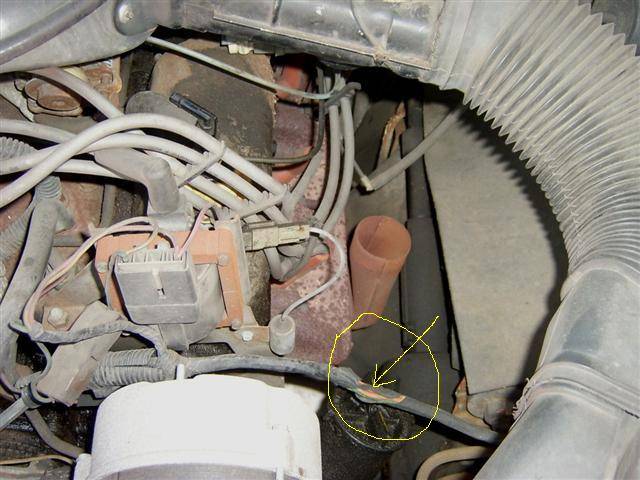

In the same shot above, looks like there is a vacuum port on what looks like a PVC fittting that ought to be capped off too. It is behind the coil, by the first wire loom separater deally. [Black fitting]
Also the Heat "stove pipe" that connects the exhaust manifold to the bottom of the air cleaner housing snorkel. There is a flapper in there that allows heated air from around the exhaust manifold to enter the engine when it is cold, allowing the engine to warm up quicker.
