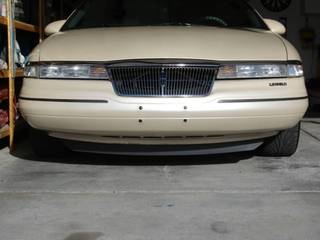

I've noticed my car running down the highway would creep up above the "A" and saw on here where these cars are supposed to have a chin spoiler. Well the previous owner had done 1 too many Dukes of Hazzard jumps and curb scrubbings so mine was gone. I was messing around the shop at work and decided to make my own. Sheared some aluminum and put it on a brake and walla- instant chin spoiler. Yes it does make a difference, 80 degrees here today and all the way home my temp guage never got off the "A". Kinda gives the old Mark VIII a little bit of NASCAR look.

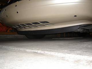

I will take a pic of mine for ya, I bought a piece of rubber stuff @ the home depot & screwed it to the origional deflector, I made it about 1/2" lower. You get the idea though, it's almost factory except it's 1/2" lower. I did this because the factory one was bent backwards a bit & this one works much better!!! Hemihed's should force a lot of air up into the radiator due to it's angle. They really do work.
Thanks for the pics TC and turborich.
Yeah, thats exactly the pic i was looking for turborich - now i can see its angle and full width. I'll See what i can 'fab up' from the Depot tomorrow!
