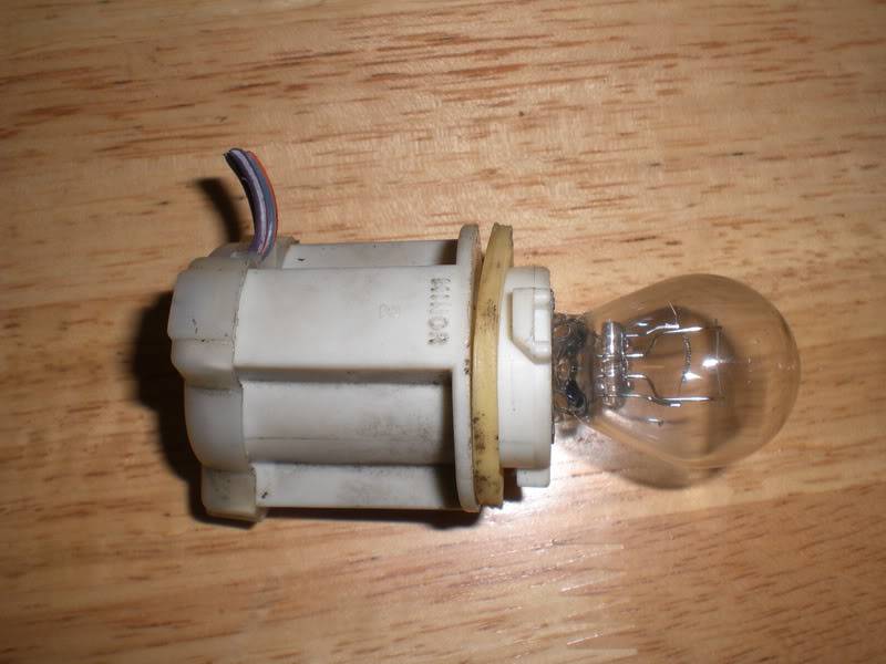

Well finally figured out what was making my damn rear light go out :mad:
It kept on going out and I would take the tail light assembly out and it would all of a sudden work again? It got to the point that it was doing it a couple times a day so I got my probe and checked the wires. Had power and ground at the wired and the base of the socket but couldn't get anything in the plug itself :confused:
So (and this is the fun part!) I took the socket out of the front of a 1995 Explorer (same thing it would seem :rolleyes: ) and spliced it in. Been working fine ever since.
Why a static socket like this would loose contact internally I cannot figure out?
Good job - thanks for sharing. Now take a sledge hammer to that puppy and wack the crap outta it!!! lol
