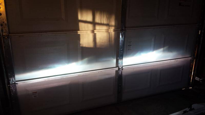

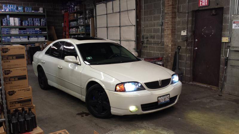

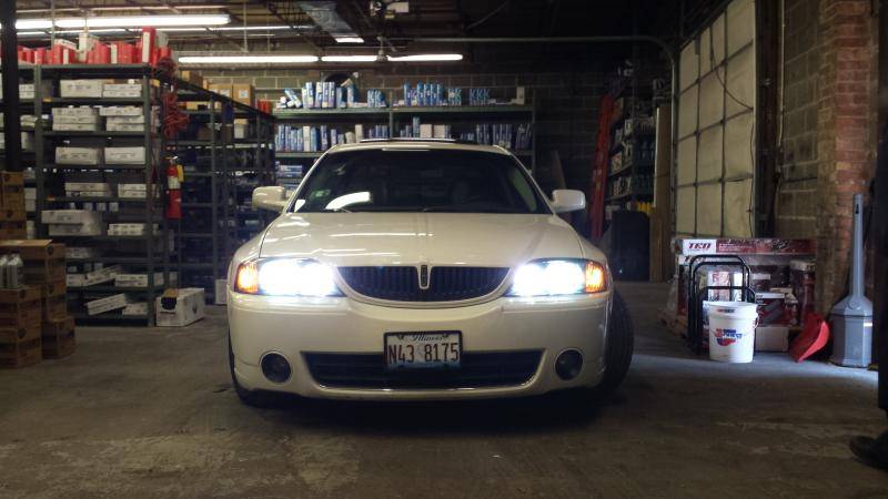

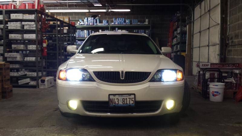

i lowered mine a bit, i still got good visibility and i do not blind anyone , there is no glare as you can see in my photos, the problem is the beam is bunched up in the middle and when it is to high you hit other cars with the beam
