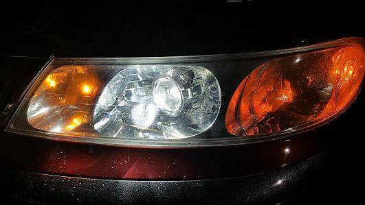

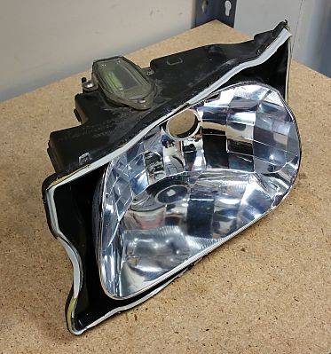

Unlike most cars, you won't remove the lens itself but instead the reflector housing comes off. It took a lot of prying / pulling but it will eventually give way. Then you're left with this:

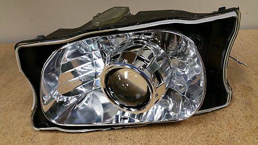

In that picture I've already moved the bulb shield. The projector is simply inserted in the hole where the bulb went and is held in place by a large retaining nut. This perfectly locates the projector without any cutting and allows the stock aiming screws to function.

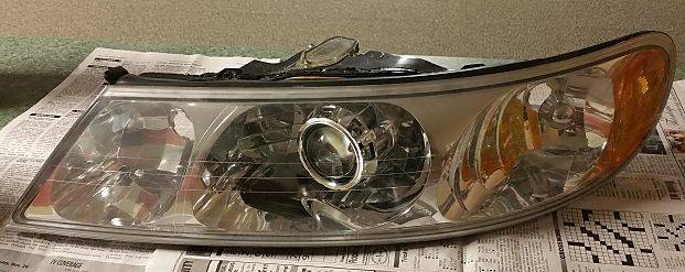

I used black silicone around the edge of the assembly and pressed it back together. Then I laid another seal of silicone around the perimeter. Better safe than sorry!

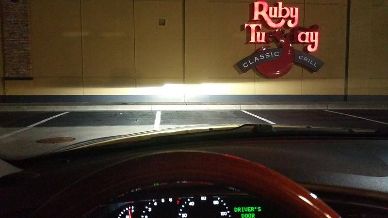

Naturally it was dark *and* misting rain by the time I finished but here's what it looks like in the car:

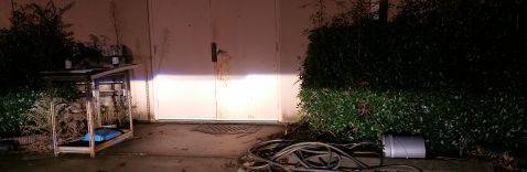

And an awful test of the resulting cutoff (better pic is somewhere -- I'll find it asap. Please ignore the junk!):

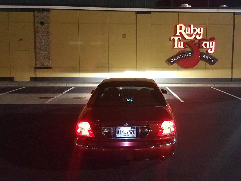

More pics!
Nice wide beam pattern. Don't worry - it's the building that's crooked, not the lights :D

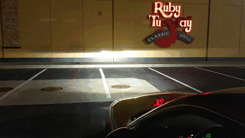

From behind the wheel:
They aren't that bright in the center. These are phone pics so it doesn't handle the output as well as a dedicated camera would. See how bright the LED tails are?
