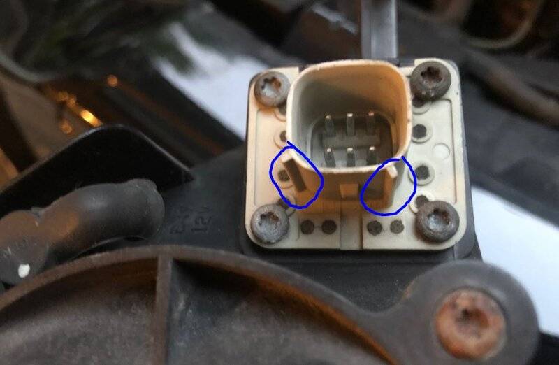

When you try to plug the connector into the headlight assembly, it won't go in. Look carefully at it and you will see that there is one keying ridge on it that interferes with it. Cut or grind that one off, and you will be good to go.

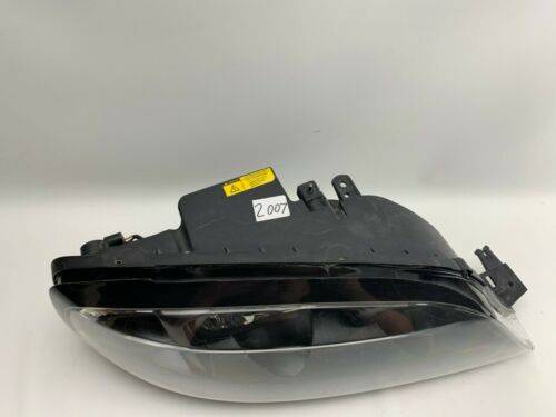

Typically, the HID assemblies have a yellow warning sticker on top, and the halogen ones do not. Note that HID is stamped into the plastic on both the HID ones and the Halogen ones.

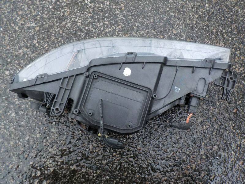

HID assemblies have a cover screwed onto the bottoms of the assemblies, the halogen ones are missing that cover.
HID - yellow warning sticker on top
HID - cover on bottom
Halogen - no cover on bottom

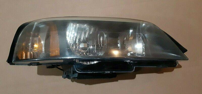

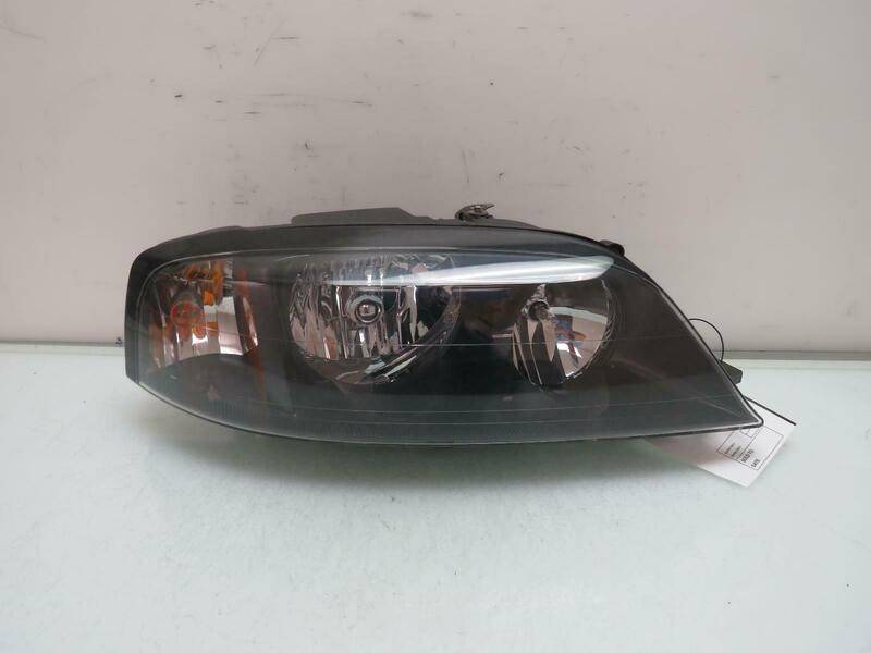

Gen 2 has two different caps over the front of the low beam bulb. If it's a smooth spherical shape, it's a H11 halogen housing. If its more like a octagonal disco ball, it's D2R HID. That makes it a little easier to ID lights in junkyards and rules out aftermarket HID bulbs.
Note that all gen 1 has a faceted pentagonal shape and all are 9006 halogen.
HID
Halogen

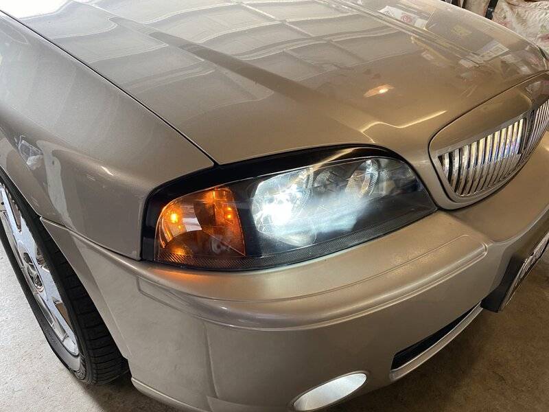

I’m using the 4700K on my 2005 LSE in the picture. I would stick with name brands for reliability (Philips/Sylvania/Osram). They are a little pricier though. You get the best deals on Amazon, but you can find the DR2 bulbs at most auto parts store but they’ll be highest price unless you get on sale.

Before I cut or grind anything I want to make sure I am looking in the correct place. I assume I am grinding down one of both of the ridges I have circled below ?
Yes. I think it is just one of those two, but I can't really remember for certain.
I just did mine on my 2005 LSE and I filed down both because it wouldn’t line up. They work great now.
