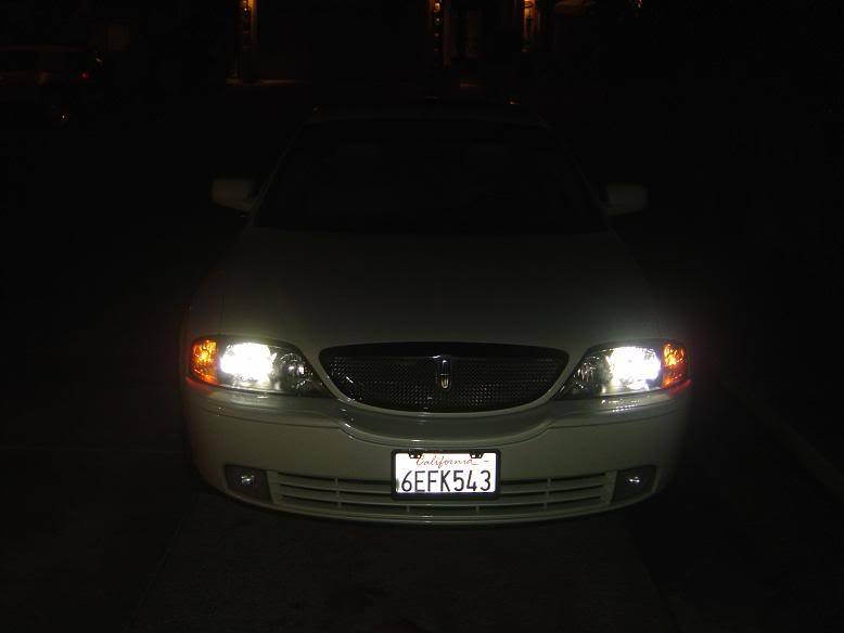

This is a bad photo of the OEM HIDs, but it is crisp white. I think higher than 5000K is where it starts to blue out.
