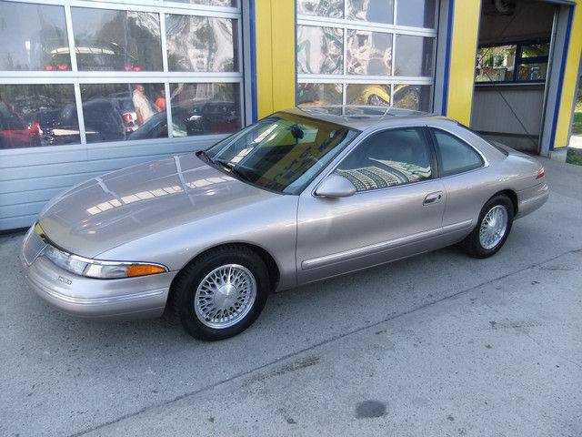

I always loved the cars styling and finally decided to get one which is harder than it might sound. Reasonably priced Mark VIIIs in good condition are incredibly rare here (they never sold them in europe) so I had luck when a pretty nice example with only 101k miles came up on the internet not too far from me. Its a 95 non LSC model, the color seems to be "Champagne" with "saddle" interior. Would have preferred a black LSC but meh, I wanted to have a pre-facelift model tho which I got. The last owner was an older guy who seemed to take care of the car, looks like the last thing he bought for it was the air ride compressor. The dealer I bought it from seems to be specialized in BMWs but they have a Hummer renting business as well, thats probably the reason why they took the car to see whether it makes sense to sell more of them. Turns out nobody wanted to buy it (there have been 2 or 3 guys looking at it to get some cheap "performance" car but the dealer was looking for someone who at least knows a thing or two about these, so no sell). Good for me, I got it for thousands less and seems like its in great condition.

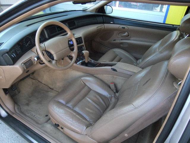

The cars still at the dealers lot right now, unfortunately I do not have the time to take pictures or register it right now, those will probably follow at the end of the month. Got some photos the dealer took though.

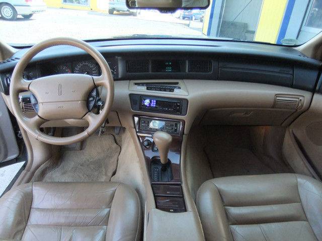

Actually, it appears that you may have a 94 model instead of a 95. The 95's had a slightly different dash layout with a larger double-DIN stereo opening. Of course, it's possible someone did a dash swap at some point, but typically most people are swapping 95-96 dashes into 93-94 models instead of the other way around.
Anyway, that is a great color combination! My parents had a 94 with that exact same exterior and interior color (or VERY similar) back in the 90's, and I'd love to come across another for sale locally in that color now. Of course, I'm partial to black Mark VIII's as well (especially since I used to own a black on black 93).
Thanks! Yeah, it could be a '94, it was registered first in '95 and afaik they sold 1995 MY cars in late 94 as well (like pretty much everyone) so I wasnt sure. There arent many differences except some colors between those 2 years tho, right?

Nice! car looks clean! the only differences I know of between the 94-95 model years were the different exterior colors, the dash was different, some 94s had black window/doorlock buttons, color keyed shifter knobs instead of black, rear bumper had no exhaust cutouts and different exhaust tips..I'm sure there's more that I may not know about too..
Welcome! That's a good looking color! Very subtle, sleeper look. And clean I may add.... looks like you got a good one.
