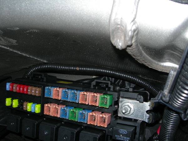

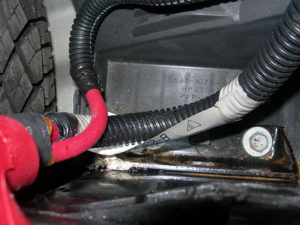

Not sure if this is what you're looking for... but hope it helps.

Cammer, your post bonked me on the head like a thick rubber mallet. The factory radio is still in the car and I'd never noticed any of the speakers not working, but there was a lack of bass. I have a feeling that these wires were wired for subs that were removed prior to me buying the car. 04_Sport, thanks for the pictures of your trunk. That just confirms what Cammer said. Maybe this weekend I'll chuck a battery in and try to fire her up again. I really appreciate the feedback guys. Take care.
