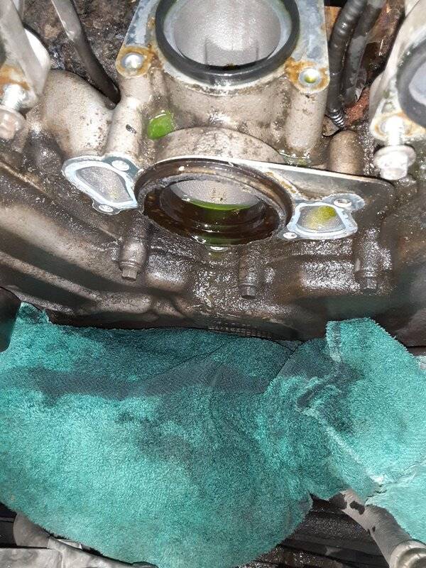

Glad you are on just removed the old water pump there is a metal plate and hard rubber gasket on the engine housing does that come off and if so how?
I think the first gen uses a big o-ring and a gasket for the water pump. Metal plate? Are you taking about the timing cover (whole front of the engine)?
Here you go

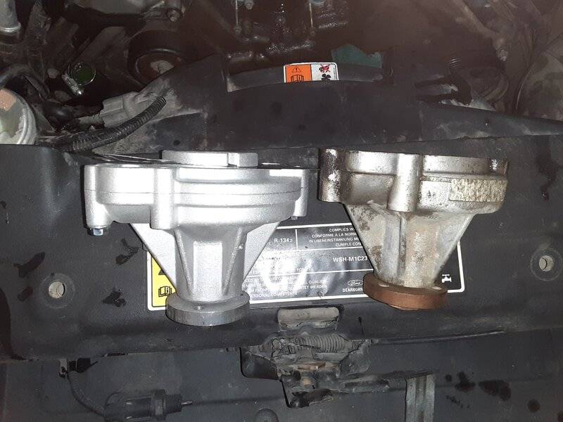

That "plate" does not come off. The rubber seals do. Four are showing in your other picture on the other thread.
