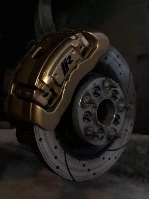

Ok so here’s the scenario. I installed my 06 Jaguar S-Type R front and rear brakes plus some Bilstine B4s with H&R lowering springs on my 06 Lincoln LS almost two weeks ago. From the gate I had a few hiccups which I’ll touch on for context.
I missed in the very few write ups on this swap that you have to grind down a little material on the mounting bracket up front. I installed everything and it was all not moving and bound up. No biggie. A little grinding and I was back in business.
No on to bleeding. Like a dummy I didn’t document what calipers went with what bracket (which is marked for L or R) when I took apart for smoothing and paint. So I finally found and article and thought I had the right parts matched. Well I didn’t and the bleeders were on bottom. Dumb move #2. Well didn’t want to take the caliper apart and ruin the paint, so I found away around that. Successfully bled the system and all seemed good.

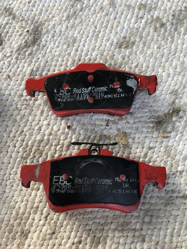

Yesterday I pulled the wheels off jacked it up to inspect everything. It all looked good (aside from some rear bushings that will need attention sooner than later lol) everything is right and mounted as it should. Parking Brake cable is routed as before. Just because i wanted to test the parking brake again and decided to film it. This time, keep in mind after a handful of times driving, the parking brake tried to engage, failed and disengaged, then it gave me the service parking brake message and light on the switch. I though maybe the pads were backwards but doing some research I am not so sure that is a factor. I had the pad with the spring on top on the inside and after attempting to switch it, I'm not sold it goes the opposite way I have it.
