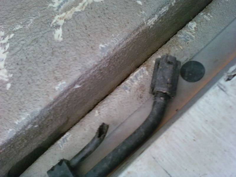

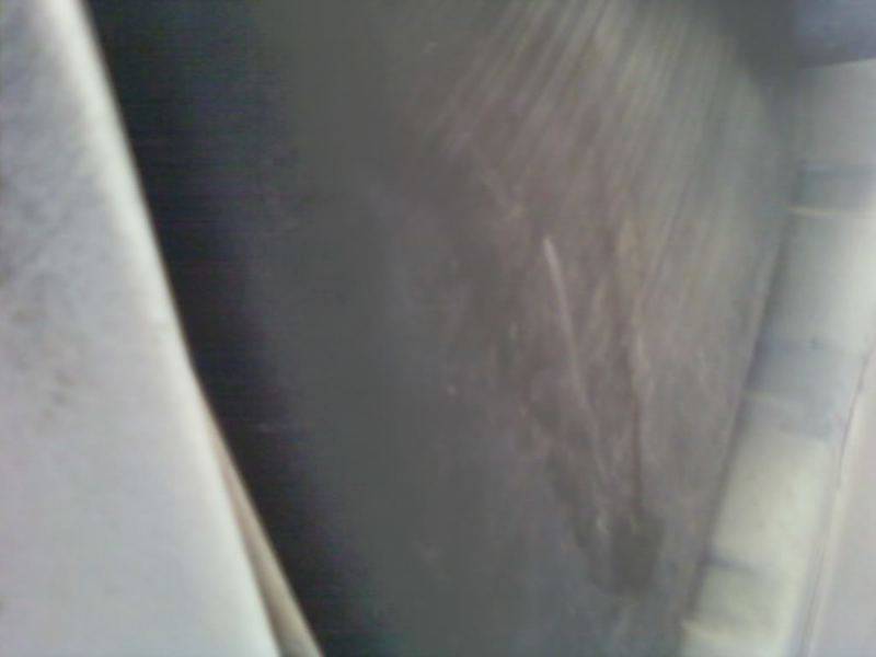

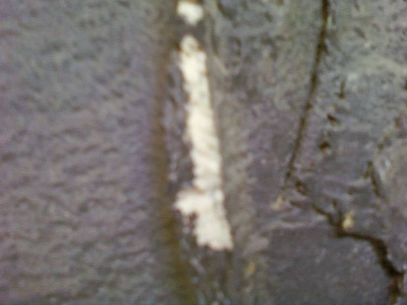

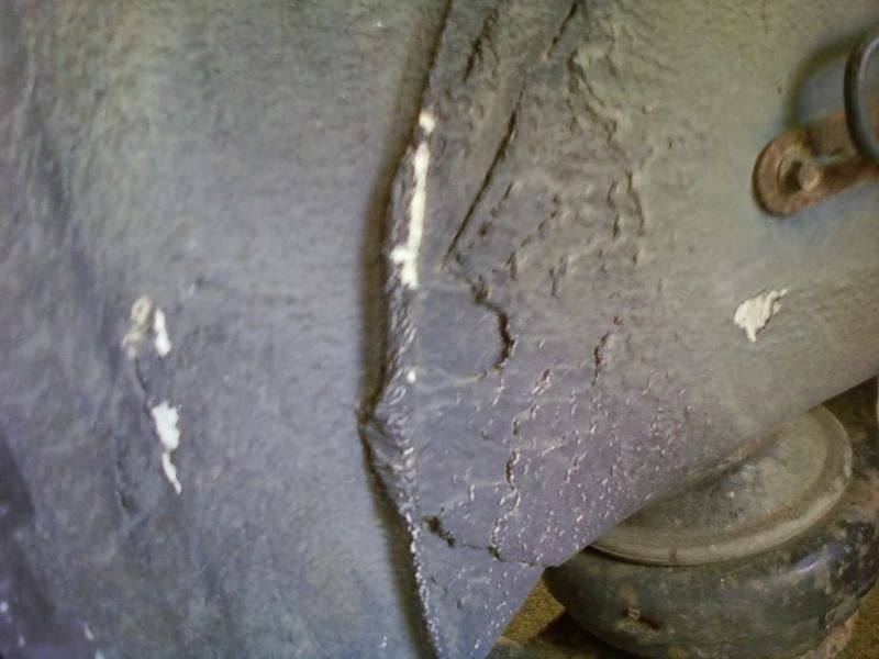

ok i jacked my car up, put it on jackstands, and let it run for about 20 min. and nothing no smell,no drips,nothing. the first pic is of the vent lines under the bumper. completely chewed off. the second is of the stain i found on the tank. thats where i thought it was coming from. it is on the driver side. the rest are just some pics of chew marks in the inner fender. i am getting the feeling it has chewed a hole in the top of this tank.
