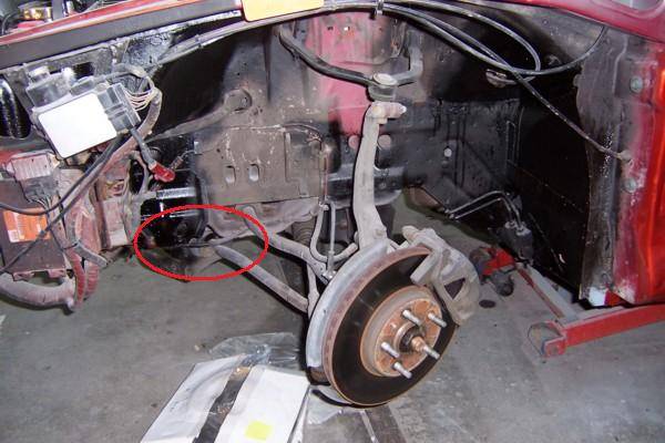

Here Ya go...
strut rod is the thing that goes from the lower control arm to the frame, the bushings on that thing usually go.....
Strut Rod Bushings – Front. If they are worn, the control arms can move and cause the vehicle to pull left or right. If the bushing look like they are cracked or even shiny, they probably have too much play in them.
