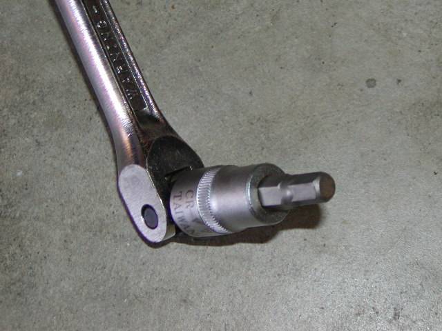

Lol why did no one inform me of this hex hold feature on the end links BEFORE I sat there all day with a hack saw.... does anyone have a picture of the hold part?
If you have new end links, it is the part after the thread ends, hex shaped..you put a socket on it. Those ratcheting box end wrenches work great with the hex hold feature bolts, but as NY said, when replacing them, tighten until the bolt breaks. That would be a lot of tension, by the way, on hardened bolts. I usually have to wire wheel the studs sticking out of those nuts, on hex holding feature-equipped parts, before the self locking nut can make it through the corrosion. Some anti-seize on that bolt may work better at allowing its removal with crusty corroded bolt threads, fwiw.
