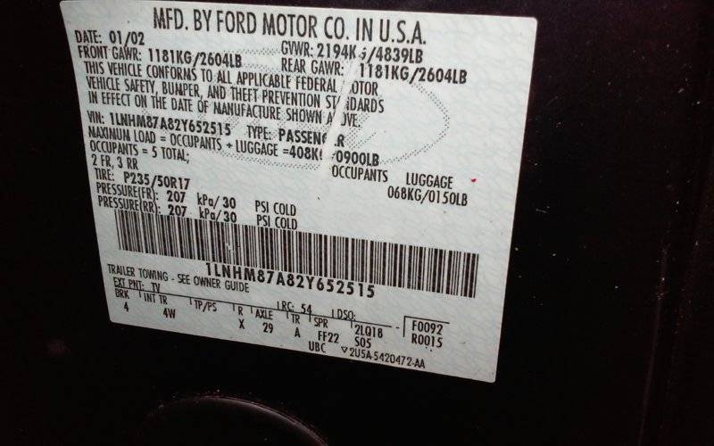

I downloaded the shop manual for my 02 LS but some of the codes don't match.
The paint code seems right but the interior color says black but mine is grey.
It also has a 4 for the brakes but the manual say it should be a 3 or 6.
The rear axle codes are single digit but mine says 29
And it gives a numeric spring number but mine are letters.
Can anyone help decipher my sticker?
Thanks but I've already decoded the VIN. What I need help with decoding is the "Vehicle Certification (VC) Label Reference" section at the bottom underneath where it says "TRAILER TOWING - SEE OWNER GUIDE".

I went and tried the ETIS site but it doesn't work right for me. At first It didn't give me anything. Then when I registered as a delaer/shop it gave me the basics similar to what you posted above but stopped before the "Minor Features" which it doesn't list any of.
My door sticker also says a manufacture date of 01/02 (maybe it also means I am lucky and got the metal tensioners? Crosses fingers) which I guess makes it late in the 02 production run but the ETIS site gave me a date of 09.01.2002. Wouldn't that be the 2003 model run? Unless the format means January 9th 2002. Maybe that's it. It also says it's the "High Version". I know mine has the Sport Package but does high version mean it's the Premium Sport package? I don't have the chrome on the bumper covers.
I think they were all the "high version."
The sport suspension is listed as "special."
Well from what else I've seen on here, I have the sport package. I have the SST shifter, no wood grain on the shift knob or steering wheel, no chrome on the bumper covers and 17" wheels.
Yes, sounds like sport. Premium sport would have the wood grain as well.

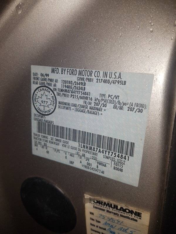

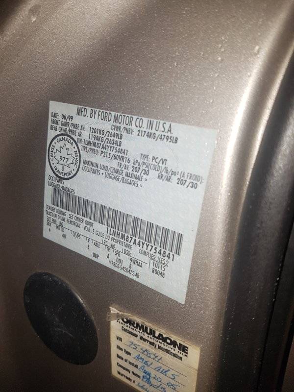

Luna, is yours a medium gray or a dark gray? Gen 1 "black" is not as black as gen 2 black. More of a dark charcoal. For medium gray, I've only seen the 2-tone medium/light gray interiors
Duke, your trim is parchment presumably
Going back to a 2008 Pektel post here on LvC on interior trim, the number is the material and the letter is the color,
for 2000:
4 - leather interior
3 - cloth interior
W - Midnight Black
T - Truffle
H - Medium Parchment
2 - Light Graphite (Not available in cloth interior)
this thread also mentioned 6 is perforated leather
