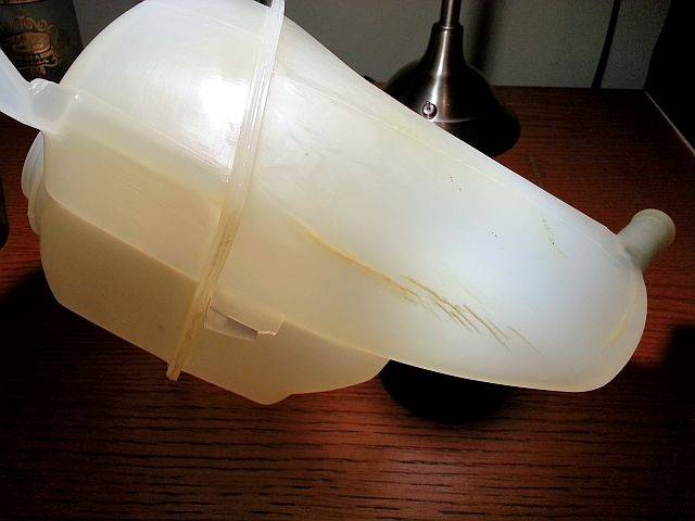

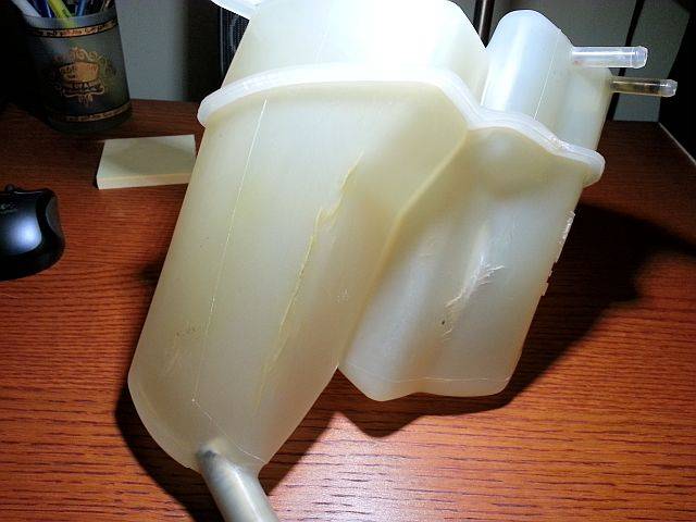

˄˄˄ Looks a lot like Big Rig's bottle....... Cracks in pretty much the same places....
Mine ...
They all seem to crack around the same area.
~ weird part was, I never overheated, intermitten heat loss then completely one night.
~ second top-up and rebleed, finally she began to leak behind the drivers front wheel.
