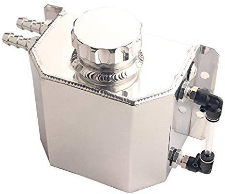

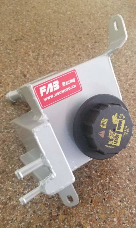

I saw the ebay aluminum degas bottle a while ago and then ran across this one ...obviously this universal won't work but I'm thinking about putting the clear plastic pipe in the Ebay aluminum degas reservoir....its made in China so I will be waiting to here from you about the quality...hopefully the welds are solid
I have access to someone that is a welder. If I order it I was thinking to have them look at it first to make sure it does not need any reworking done to make it stronger.
That's absolutely fantastic that someone took the time to make one out of metal and not that cheap shit plastic garbage the others have been made from. As far as strength goes, the cooling system is only under what, 15 psi? That's basically nothing. If you want to see if the tank is in good shape, fill it with something thin and obnoxious like gasoline or acetone. If there are any holes in the welds, that will show it. You could put some chunks of rad hose on on and just hold them higher than the filler neck to get the level to the top without it leaking everywhere.

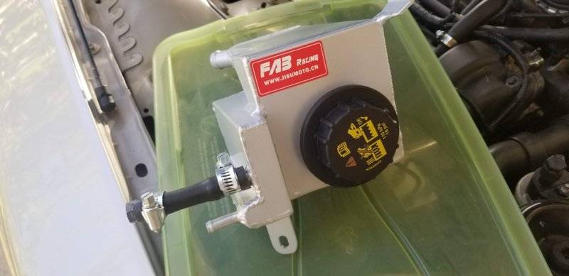

Just wanted to do an update on my metal coolant tank install.

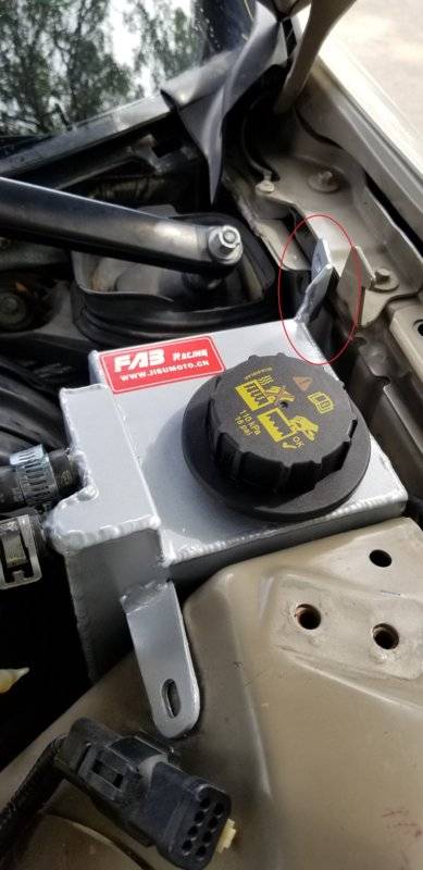

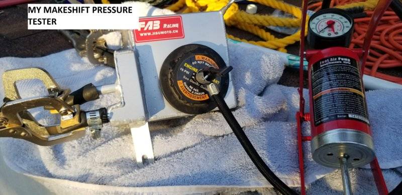

It wasn't an exact fit but close. First thing I did was to pressure test it.

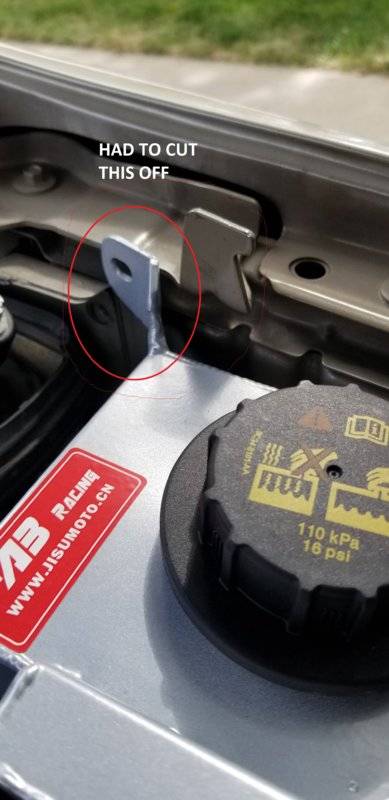

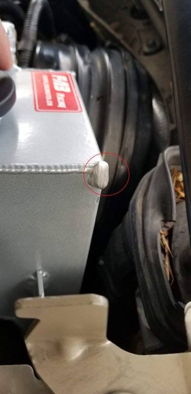

I then needed to cut off a tab that wasn't even close to where it should be.

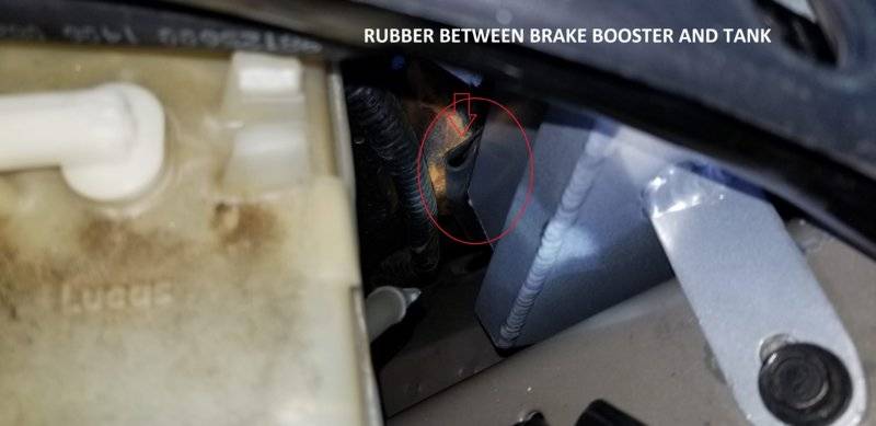

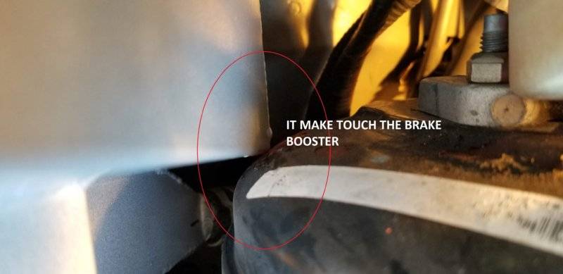

It also seems to be touching the brake booster. A little rubber between the two seems to have helped in case of vibration.

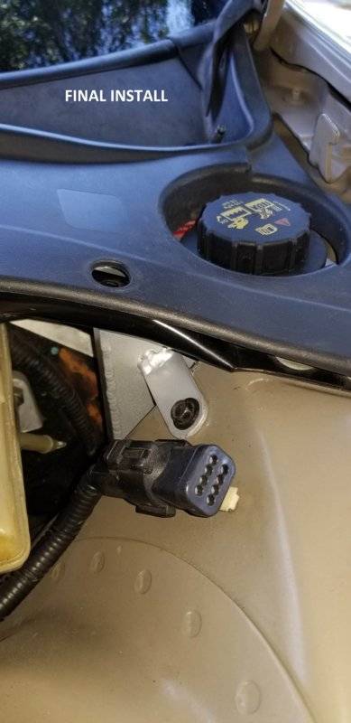

Other than that, its been in for a few month now with no overheating issues.
