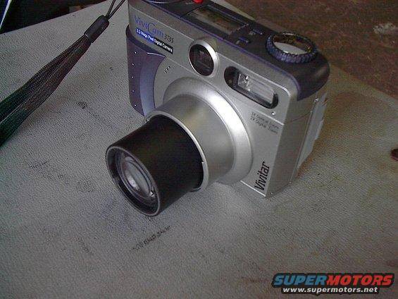

Thanks guys
I do it with a three year old POS Vivitar digital that cost under $100.00 new. Just a 3.3 mp with an optical zoom and the all important macro (or close up) option.
The best advice I can give is flood the area with a lot of light(trouble light) and steady your arm against the car/truck frame and wait for the button to do it.
