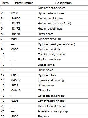

the LS (at least the V8) has a very complicated cooling system.
there is a secondary electric pump that routes coolant into the heater core - so if the bleeding and flushing do not solve your issue - start checking fuses, and the secondary pump.
it could even be a loss of pressure - degas cap or degas cracking
