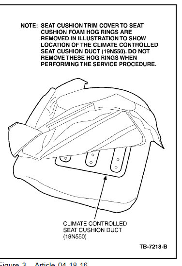

Final Edit, After 40 minutes I finally found the TSB, now I just gotta figure out how to delete threads...
Is there any videos or photos of the someone doing the TSB for the 03 heated seat duct crush?

Joe, the TSB says it takes like 4 or so hours to do this, I'm not the most mechanical of a guy but I do know one, how hard is this? I really don't want to get in over my head to the point where I'd have to pay for the broken thing plus the fact that I effed it up more.
Four is about right, if you have the correct tools, like the hog ring pliers. You'll also need hog rings and such.
Can I substitude the hog ring pliers for more duct tape ;)
Joe Im seeing here that it says the hog rings are removed for the illustration, but it says not to do it for the prcedure
Okay. I thought the seat cover had to come off. It's been a while since I read that TSB. It must not completely replace the duct. You can see it near the end of the seat cover thread. Yours is a 2003?
